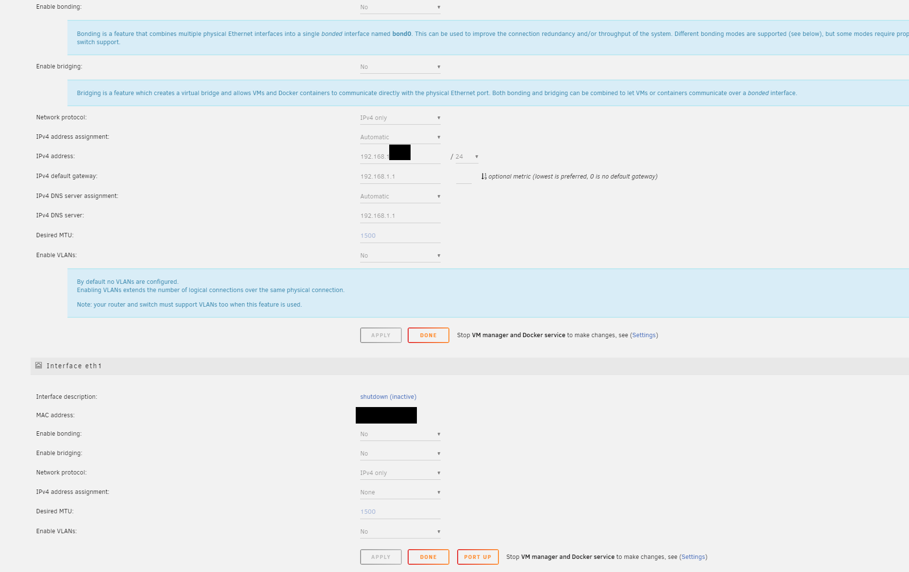

UNRAID grabs all ethernet ports across IOMMU groups.
Objetive is to isolate one NIC port for pfsense VM, and other NIC port for UNRAID with security and stability. Are these the only options?
1) Enable bonding, bridging, and VLANs in tab "Network Settings" for both ports in NIC card.
My switch supports VLAN & link aggregation. The bonding will double the 10GbE throughput for UNRAD and pfsense
The bridging option will allow pfsense VM to access the bonded UNRAID physical ports
The VLAN option can provide isolation between pfsense and UNRAID.
2) Motherboard supports bifurcation (I've used this successfully elsewhere). Bifurcate x8x8 and install a second NIC card.
Will this result in bifurcated NICs with separate IOMMU group?
3) Get a motherboard that supports virtualization better. Which ones in ITX form?
4) Use 'vfio-pci.ids=19a2:0710' will this give each Ethernet port on same NIC their own IOMMU?
The options below fail the security requirement since devices are not truly isolated
5) Use 'pcie_acs_override=downstream', if this fails, try 6)
6) Use 'pcie_acs_override=downstream, multifunction' (may not be truly isolated)
Thanks for help with this difficult topic.
