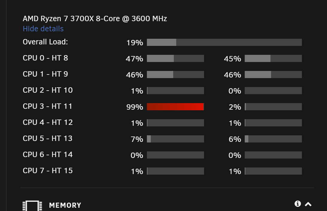

also i notice at times  in the pic  the one CPU is pinned at 100%  can you tell me what one is doing it..  and why not the HT also..

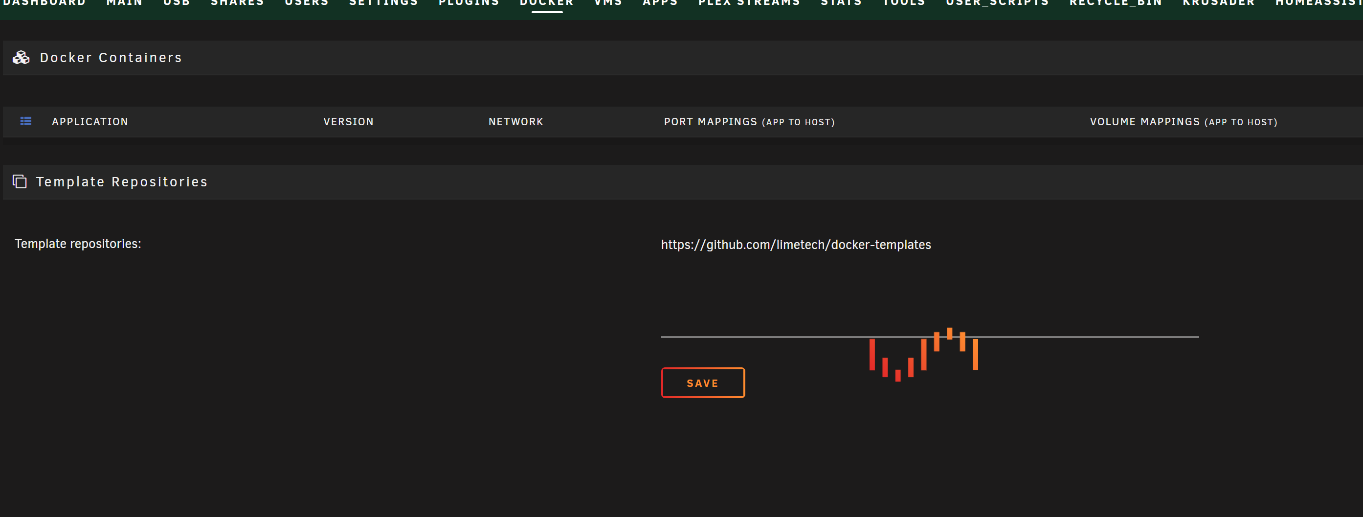

right now its been sitting at this screen for 20 min...and a fresh of the screen doesnt help  just doesnt populate. and i find this after i have my drives powered down   etc
but when you normally do a reboot  then the docker is fast again pretty much...
and what happens when i do finally get it  icons  of dockers are gone and are replaced with   a circle ?  inside the circle

If the Unraid spinner doesn't disappear after 120 seconds (or 480seconds on 6.10 when it goes stable), then it will never disappear
The icons showing "?" are what the actual problem is.  The docker system if the icons do not exist locally attempts to download them.  And something in your network is blocking that.  Are you using piHole or something?  Try setting static DNS addresses of 208.67.222.222 / 208.67.220.220 instead of using your router as the DNS server.

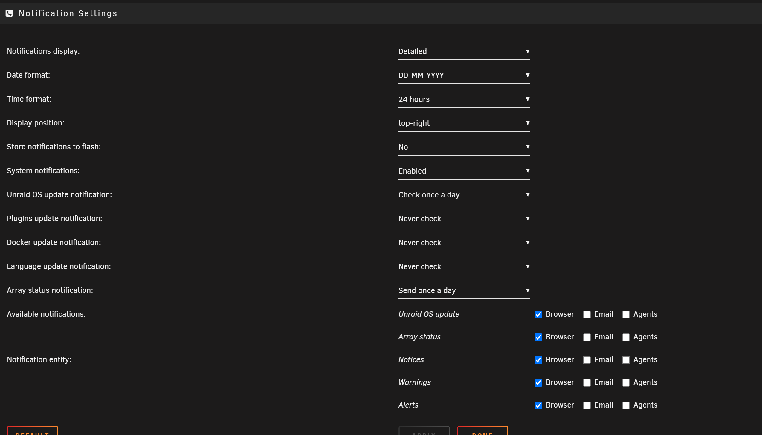

also  i know i followed a video when i first got unraid like 2 yrs ago  something about turning off updates to docker and plugins  so its supposed to speed it up. so docker shouldnet use internet.. just the updater plugin   the check for plugins and dockers at 12am every night and then updates..

If you have in Settings - Notification Settings the check for docker updates disabled, then the OS will not check for updates.
However, whenever you go to the CA tab it will automatically start a background process to check all your installed apps (plugins and docker) for updates if it hasn't been already checked by CA within the last hour.  This can be disabled in CA's settings.
Additionally (but not directly related), many plugins will also automatically check for updates available to them (in the background) whenever you hit their page or settings.  This includes every single one of mine, UD, parity check tuning and one Dynamix branded) - IE: Whenever you go to Apps, it will always check for updates to itself.  This behaviour cannot be disabled

New to the forum, so not sure if this has been discussed a lot but my NAS always has cpu problems with linux.
I've had problems with 1 or two cores stuck at 100% usage, tracked it to usb auto suspend.
usbcore.autosuspend=-1 disables autosuspend and after reboot its back to normal.
