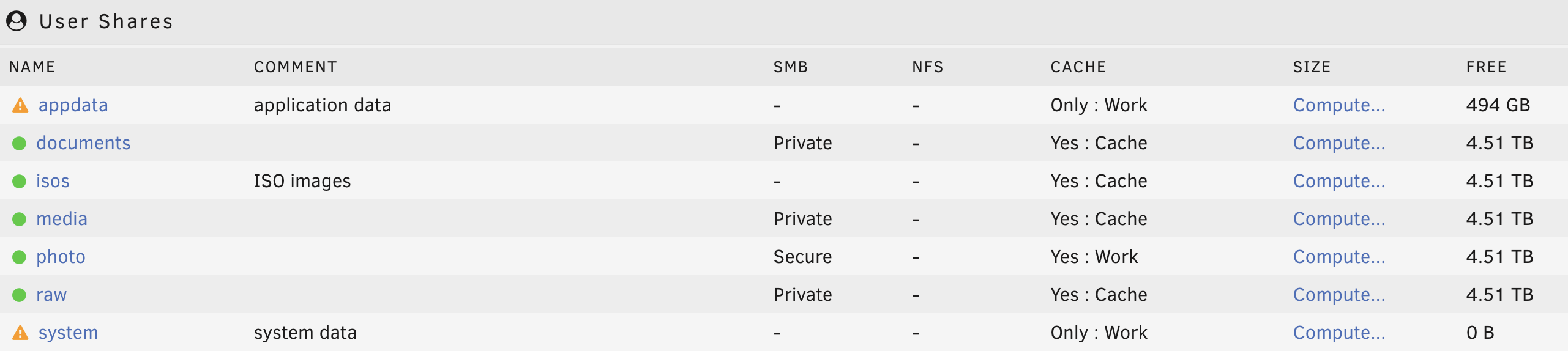

I have 2 cache pools : 'cache' and 'work', each using 1 dedicated NVMe drive. I would like both appdata and system to live on 'work' (Cache Only).
For some reason though (maybe I messed up at the beginining), system currently sits on 'cache'

and changing "Select cache pool:" on the Shares tab doesn't seem to do anything about it, outside of strangely reporting 0 B free
1219104621_Capturedecran2022-01-08a18_43_40.thumb.png.4d2a0dcd4af2b85256f0de634b364862.png
What's the correct course of action here ? Do I need to move folders around manually ?
