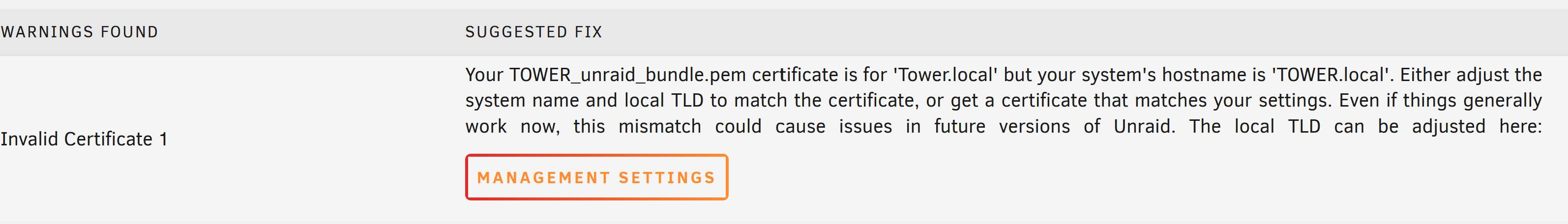

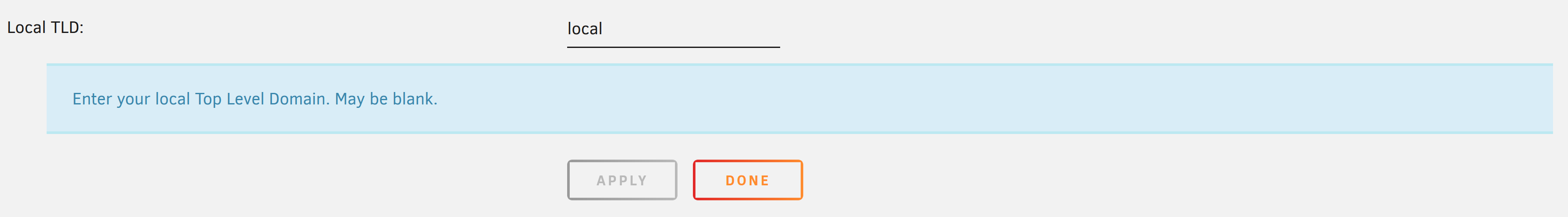

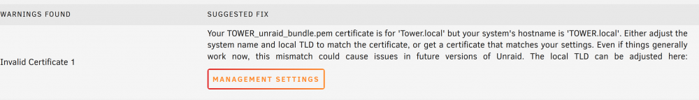

I'm also seeing a similar warning message, also with a slightly different setup. I currently have the following set in Unraid:
Settings > ManagementAccess > Local TLD: local
Settings > ManagementAccess > Use SSL/TLS: Auto
For the Server's name, I have
Settings > Identification > Server name: PHOENIX
My last Fix Common Problems run resulted with this warning:
Your PHOENIX_unraid_bundle.pem certificate is for 'Phoenix.local' but your system's hostname is 'PHOENIX.local'.
Either adjust the system name and local TLD to match the certificate, or get a certificate that matches your settings.
Even if things generally work now, this mismatch could cause issues in future versions of Unraid.
Things are currently working as expected, but I'd like to avoid any future issues.
Edited by nerdzero
Fixed a formating error.
Link to comment
This is an error with our test, the next version of Fix Common Problems will fix this. It should be doing a case-insensitive match since 'Phoenix.local' and 'PHOENIX.local' are the same as far as DNS is concerned.
