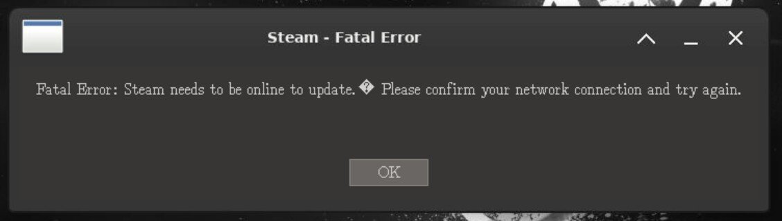

Just installed steam-headless but can't get it to work - WebUI gives me the noVNC screen but when I click Connect, I get "failed to connect to server".
I have the exakt same problem. I don't have any graphics card installed and want to use this container solely for Steams "Game File Transfer over Local Network" feature. May you can point me in the right direction.
Thank you!
Here are some logs:
Build: [2024-08-24 02:48:43] [master] [860451da74b397385f1b1658545d2bb891aa8e46] [debian]
all values are hidden

I continue to get "Steam - Fatal Error". I followed the GitHub guide which appears to be the same guide at the beginning of this thread. I'd appreciate any help as I think this Docker is an amazing idea!
