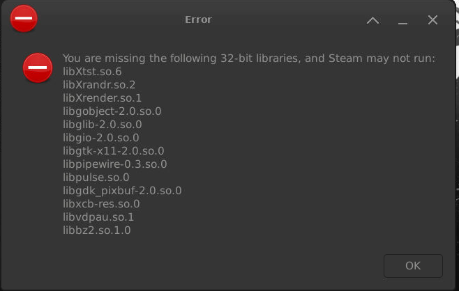

Steam-headless was working fine, then all of a sudden today I get this:
Searching this issue, I found suggestions of several commands to run to install these libraries but I get some sort of permission denied error every time I try. The only change I made to my server was that I changed around the configuration of drives in my cache pool, but I know there wasn't some catastrophic damage to my appdata folder as all 20 other dockers I have installed work fine. The cache was completely 0.00B used of 2TB available when I swapped disks around.
I tried a completely fresh install of steam-headless because my game library is on a separate share that I can just point to at any time, but I got the same error.

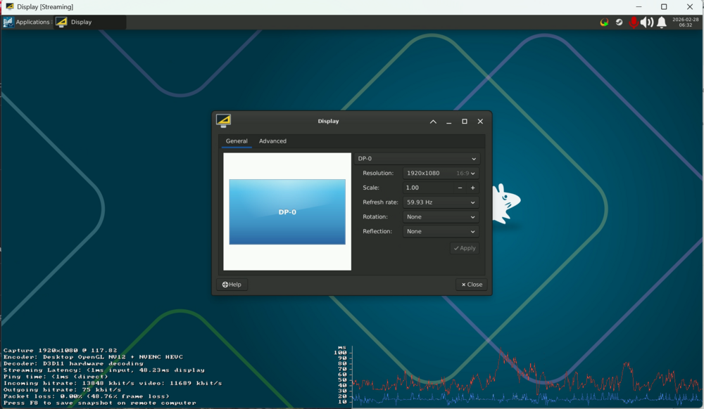

Hello, i was hoping for a little help.
i cant get steam headless container to have a different refresh rate then 60hz. i bought a hdmi dummy plug and now i can see higher resolutions but cant change the refresh rate.
any help would be greatly appreciated.
I think some of these dummy HDMI adapters are not so good....
Mine are supposed to do 4k 120hrz. Even though I can set it in the panel, in game never gets over 1080p. I think I just have to hook up a real monitor. For it to work correctly.
