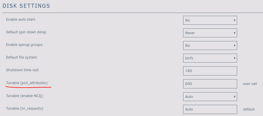

I don't know where I can find the SMART polling timer setting, do you mean
SMART capabilities:0x0003Saves SMART data before entering power-saving mode.
Supports SMART auto save timer. ?  I am sure I wouldn't have touched any such setting, so it should be at default, if there is any...
In the SMART report:
Try check below setting, I set 600 means polling every 10min.

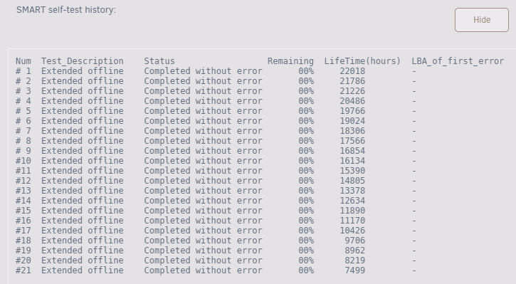

Pls note all extended test was "abort by host", never complete.
SMART Extended Self-test Log Version: 1 (1 sectors)
Num  Test_Description    Status                  Remaining  LifeTime(hours)  LBA_of_first_error
# 1  Extended offline    Aborted by host               90%      6231         -
# 2  Extended offline    Aborted by host               90%      6203         -
# 3  Extended offline    Aborted by host               90%      6089         -
# 4  Extended offline    Aborted by host               90%      6083         -
# 5  Short offline       Completed without error       00%      6081         -
A normal test result like as below
Edited by Vr2Io
