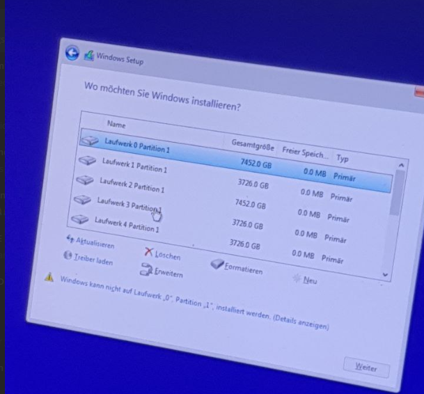

I have now done a BIOS update on the raid controller. It is still not recognized by unraid. Now no more error message in the log and under system devices he is also no longer inside. Have now made a windows 10 bootsick to test. All hard drives are displayed in the installation menu.
