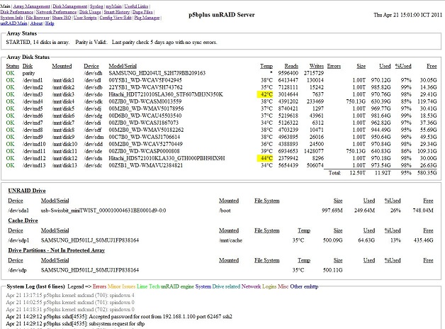

Awesome Joe!, had the same issue. Many thanks.
