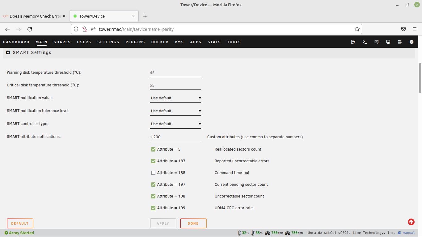

Thanks for the suggestion.  I will add attributes 1 and 200 to be monitored as you suggest.

Is this the appropriate place to initiate monitoring 1 and 200 attributes?
yes
