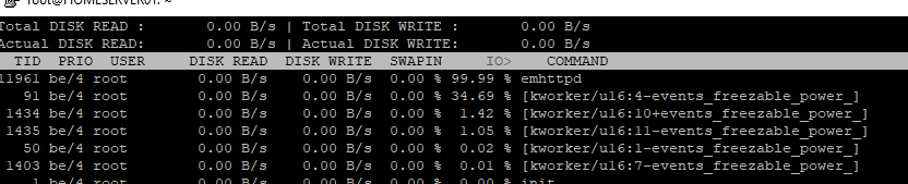

Yes, this should be normal as I am running a storj node. But I just saw that my 2nd 1gbit/s lan card is not recognised either. And the problem also occurs when the array is stopped.
Here is also a snip from iotop.
Edited by MrYoshii
Sorry, no more ideas then.
Could this be a usb stick that is too slow?
The OS loads to RAM during boot, then runs from there, so no.
ok but how can it come to long io waiting times here? A RAM disk should be mega fast.
Does anyone else have an idea?
Greetings Yoshii
