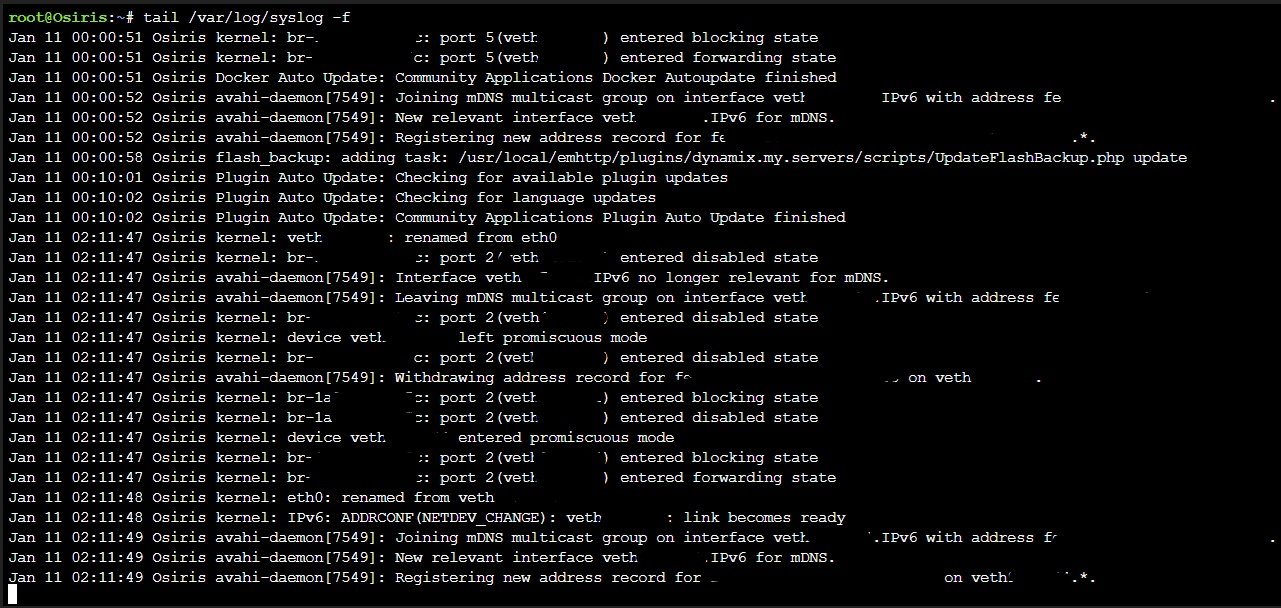

This problem started a couple of days ago. Unraid becomes unresponsive and doesn't even show up in LAN devices on the router. All the services also become unresponsive. Network shares also become unresponsive. I have tried different ports on the router, and restarted it as well as the switch.
The only way i've been able to get it back up is holding down the power button for a few seconds for a hard reboot. I have attached the diagnostics file. I also ran "tail /var/log/syslog -f" and left the window open, I marked over some information, maybe not necessary. This issue has never occured before and unraid has been stable.
