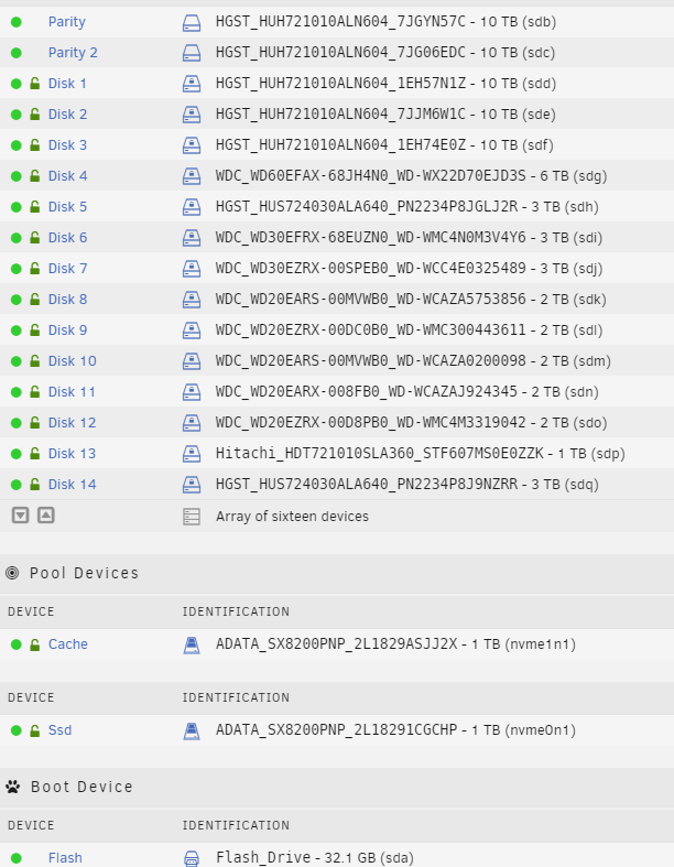

  1. SuperMicro 6047R-E1R24N 24x LFF SuperStorage Server W/ X9DRI-LN4F+
  2. 2 x Xeon CPU E5-2697 @ 2.70 GHz (48 cores total)
  3. 128 GiB DDR3 Multi-bit ECC memory
  4. Interface 1: 10GB
  5. Intel onboard 1 Gib interface
  6. 1 TB M.3 SSD (Cache)
  7. 1 TB M.3 SSD (VM/Downloads)
  8. 2 x 10TB parity Drives
  9. Assorted size drives (59 TB)

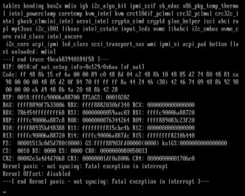

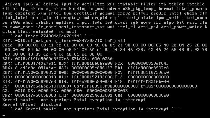

Screen Shots of several Kernel panic error messages:
  3. Here was a partial crash where the webUI was nonresponsive and nothing worked but the CLI  Had to power cycle to resolve1951518154_anothercrash12-17-21.PNG.07268dbe5cf94e4deea2c141eb913dfa.PNG
  4. Another non kernel panic but system became unresponsive non of the dockers worked similar to above.  With this said most of the crashes are Kernel panics.

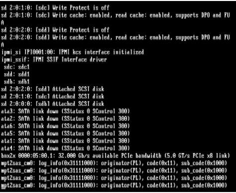

  5. 1120970840_strangeerrorunraid12-30-21.PNG.d92c03608bea783bb665647de978086a.PNG

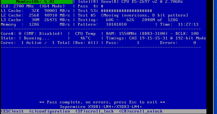

Memory check
I performed a memory check using the the Mem tool option during unraid boot.  I only did 1 pass as it took over 12 hours to perform

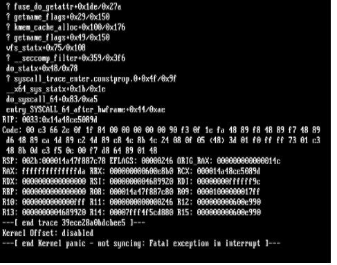

I'm back, I upgraded to the RC version of unraid, it broke my plex that was using NVIDA plugin and an NVIDA card to transcode.  By break I bean the old container would crash when I tried to start it.  I had to d/l a different docker, none of the ones on the app store, at least for the RC have the NVIDA transcode.
This time around I was able to get 2 screen shots of errors.
Also during the last 2 days 1 of my Hard drives died,  running emulated currently waiting for a replacement drive.  Should get her on Wednesday hopefully.
I do have some old hard drives 10+ years of run time that are giving some reallocation errors, going to consolidate the data and replace them with a new drive.   This is going to take a few days I have to rebuild the drive that completely died then consolidate the data off the other 3 drives before removing and replacing with the new drive.
In the mean time I am going to remove the NVidia video card and see if the fixes anything.

I ran a memtest and didn't see any issues.
 I think I might have a breakthrough, I enabled syslogs server and saved the syslogs to my cache drive according to the post here.
This allowed me to catch some errors before they were lost due to reboot.  From the logs looks like the preclear plugin was blowing up nginx web server if i'm reading the logs correctly.  I didn't get a kernel panic but I was getting no response from any of the dockers or unraid interface.  Not sure this would eventually cause a kernel panic type error but I removed the plugin and will see if unraid stabilizes.  I attached the syslogs.
syslog-10.0.0.11 - Copy.log.zip
Jan 30 01:55:40 Titanium kernel: macvlan_broadcast+0x116/0x144 [macvlan]
Jan 30 01:55:40 Titanium kernel: macvlan_process_broadcast+0xc7/0x10b [macvlan]
Macvlan call traces are usually the result of having dockers with a custom IP address, upgrading to v6.10 and switching to ipvlan might fix it (Settings -> Docker Settings -> Docker custom network type -> ipvlan (advanced view must be enable, top right)), or see below for more info.
https://forums.unraid.net/topic/70529-650-call-traces-when-assigning-ip-address-to-docker-containers/
See also here:
https://forums.unraid.net/bug-reports/stable-releases/690691-kernel-panic-due-to-netfilter-nf_nat_setup_info-docker-static-ip-macvlan-r1356/

I ran this twice.  Not sure if this was answered but is (dm-14) drive 14?  I was expecting a sd something like sda, sdb, etc.
Tried running the xfx repair from the gui several times using the -v flag no luck.  I'm considering the Aliens 2 approach and nuke from orbit.  Currently moving data off the drive and will reformat.  Hopefully that will work. :)
No,
On 2/2/2022 at 7:50 AM, JorgeB said:
post new diags after array start in normal mode.
to see which drive it is.
Ok I'm at a complete loss here on this XFS repair.
I moved all data off of drive 14, took drive 14 offline then the xfs corrupted error went from dm-14 to dm-13.
I performed a webgui repair on drive 13.  Did not stop the error.

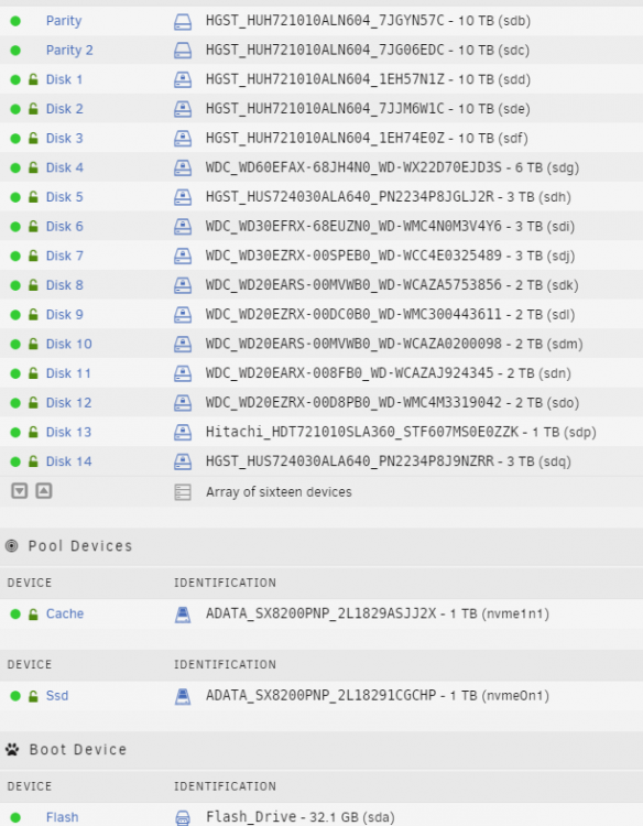

I formatted drive 14 by converting from xfs encrypted to xfs back to xfs encrypted.  xfs encrypted -> format -> xfs -> format -> xfs encrypted.  Then the corruption error came back to dm-14.
Feb  3 07:22:35 Titanium kernel: XFS (dm-14): Unmount and run xfs_repair
Feb  3 07:22:35 Titanium kernel: XFS (dm-14): First 128 bytes of corrupted metadata buffer:
Feb  3 07:22:35 Titanium kernel: 00000000: 49 4e 41 ed 03 01 00 00 00 00 00 63 00 00 00 64  INA........c...d
Feb  3 07:22:35 Titanium kernel: 00000010: 00 00 00 02 00 00 00 00 00 00 00 00 00 00 00 00  ................
Feb  3 07:22:35 Titanium kernel: 00000020: 98 8f 34 fb 84 88 ff ff 61 96 0a ae 34 dd db 6c  ..4.....a...4..l
Feb  3 07:22:35 Titanium kernel: 00000030: 61 96 0a ae 34 dd db 6c 00 00 00 00 00 00 00 1a  a...4..l........
Feb  3 07:22:35 Titanium kernel: 00000040: 00 00 00 00 00 00 00 00 00 00 00 00 00 00 00 00  ................
Feb  3 07:22:35 Titanium kernel: 00000050: 00 00 00 02 00 00 00 00 00 00 00 00 7b 94 ec 72  ............{..r
Feb  3 07:22:35 Titanium kernel: 00000060: ff ff ff ff 9c 27 7a e1 00 00 00 00 00 00 00 06  .....'z.........
Feb  3 07:22:35 Titanium kernel: 00000070: 00 00 00 b1 00 09 b6 1c 00 00 00 00 00 00 00 00  ................
stoped errors on dm-13 and moved back to dm-14
I then performed a Guix XFS-repair using -L to zero the log and then ran gui-xfs repair -V but I am still getting the error.
I am beginning to think that dm-14 does not correlate to drive 14 that the corruption is somewhere else.  If I run parity will it fix the corruption or will it just write the corruption to the parity drive?
If you provide your system's diagnostics zip file we would be able to tell you what drive it relates to.
