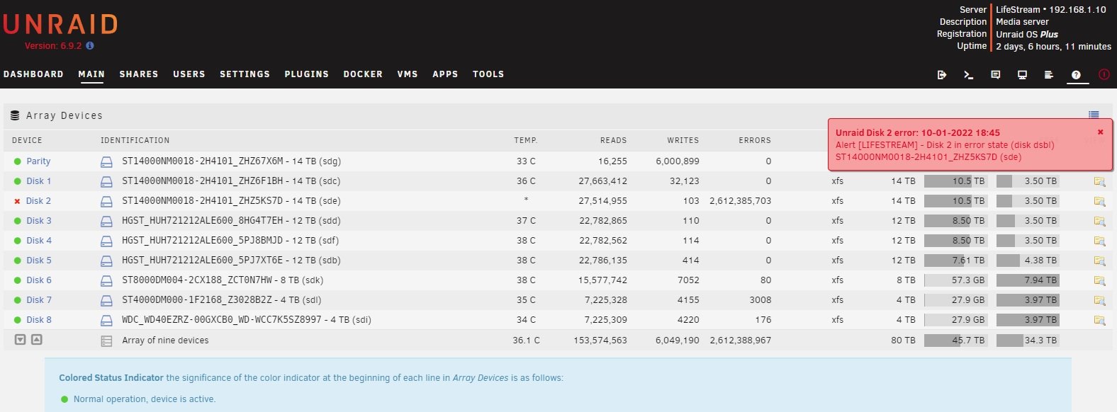

I've just built my first server. Everything installed and all of my files transferred just fine. Because I have 40TB of files to transfer I decided to create the parity once I was complete as it would slow down transfer rate or so I read. Anyway, over the weekend I started the parity and  unfortunately it somehow found 2 billion errors (pic attached). I figured something must have gone horribly wrong (maybe lost connection for a minute) for it to find that many errors. The problem is, Unraid doesn't really provide any solutions and I have been looking around and the only thing I found was to change the cable. I changed the cable but nothing. I then ran some diagnostics which I'm not familiar with. Can someone point me in the correct direction to fix this. Or do I just need another HDD? This is a new 14TB HDD by the way. I think I've attached everything that I've seen asked for in other threads.

Yep there is a SMART warning for the disk. In fact, it is now unmountable. I put 3 other drives in (1  8TB and 2  4TB) and all three has SMART warnings, though they were older drives. All three of those have SMART warning.
