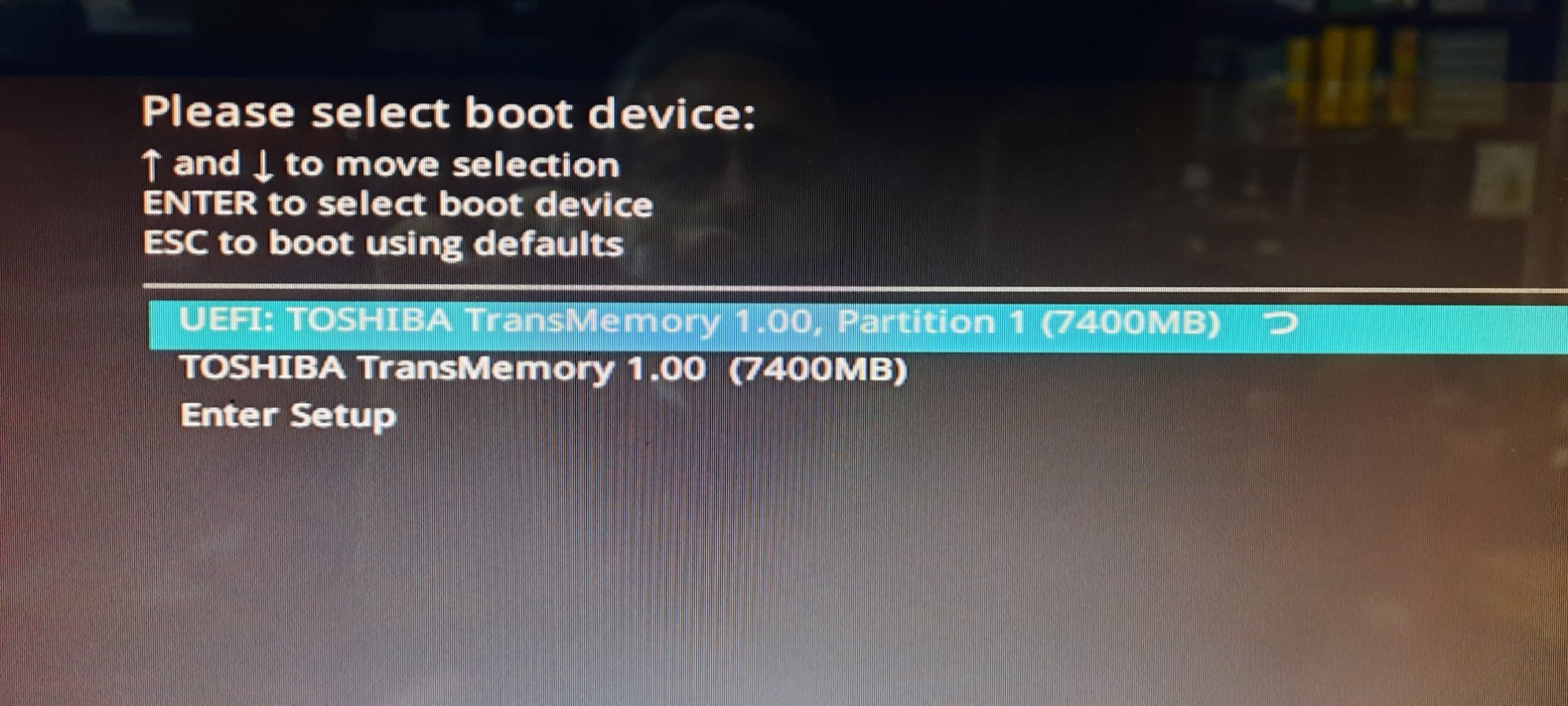

It's the same partition, if CSM/Legacy boot is enable you should get two boot options:
UEFI: Name_of_your_flash_drive
Name_of_your_flash_drive*
*Sometimes USB: Name_of_your_flash_drive
E.g. for typical Asus BIOS
Correct, I get both options. If I boot from the non-UEFI, it says it's not bootable. If I boot from UEFI, I can't boot into GUI mode.
Like mentioned there's nothing to change to enable legacy boot in the flash drive, see if it boots in a different system if available, could be a BIOS issue.
I can confirm CSM is enabled, and still getting not bootable error from the non-UEFI side. I only have 1 other OLDER machine to try, but I had similar issues with different drives when I first practiced Unraid with it. I can maybe try a different port, but strange that would matter.
