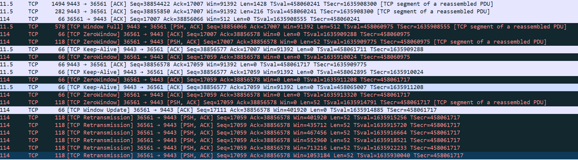

after lot of research, lof of wiresharking I see, that when websocket server send (from time to time) burst with more packet/s there tcp receive window free bytes are going to zero. I dont understand, why this receive buffer is not increased fast, when the size is not as big as in /proc/sys/net/ipv4/tvp_(r/w/)mem. I dont understand linux, not a guru, but, simple comparing windows/linux/unraid(docker,vm,nativ) shows me something bad with unraid tcp stack, or any default configuration there.
I also go through diagnostics files, but nothing found. I thing, that this is deep cfg options somewhere, when simple windows or ubuntu (nativ/vm) get this good for days, unraid for minutes :(
