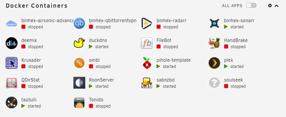

That's why I am confused. I'm nut sure what is using python. Midnight Commander has been locking up at times. Here is the docker containers I'm running if there is a clue there.
