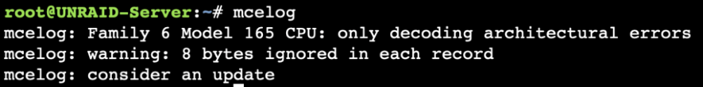

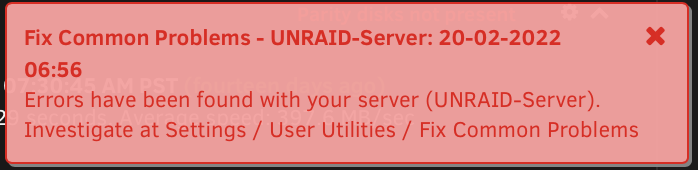

Also I get the following message on the dashboard, did I run mcelog correctly here?

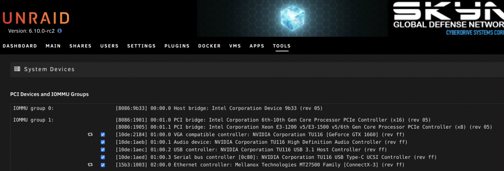

VFIO are of course selected and passed through, thus excluded during UNRAID boot:

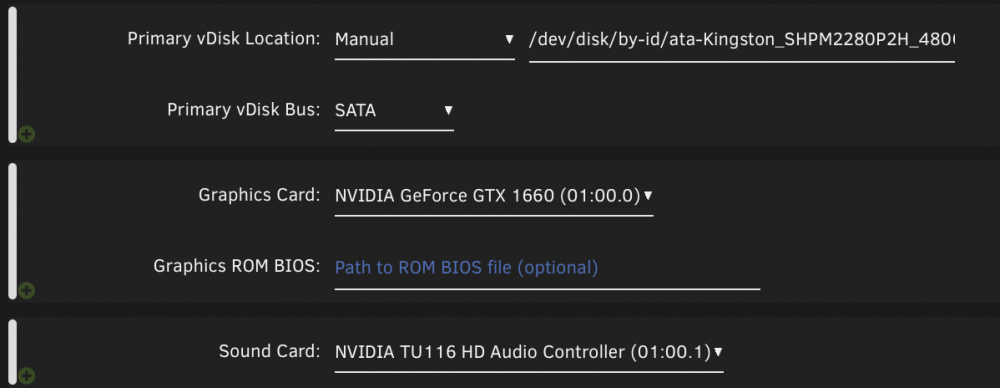

In the corresponding VM's everything is actually also as it should here the Win-VM:

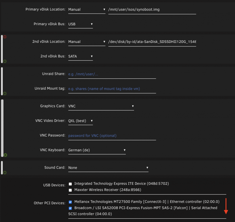

and here the XPenology VM:

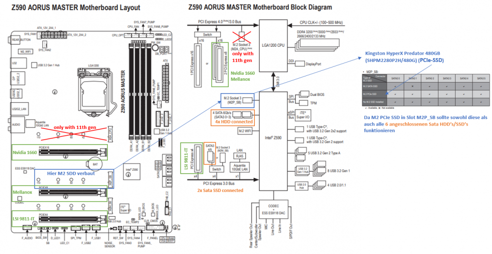

What is strange is that only the two devices in PCI slot 1 and 2 cause problems. In the third slot is the Dell 310 HBA, which is passed as LSI 9811 in IT mode for the 8 HDD's without any problems... maybe this is an info with which you experts can do something. In the Bios it says that slot 1&2 run with 8x and slot 3 with 4x. That is also so planned.

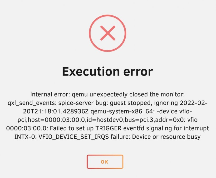

    -> Xpenology VM does not spit out 127 error anymore but still does not boot and gives the following error:

I have drawn the entire system structure for illustration:
If you see something that is not compatible I am grateful for advice. I'm surprised that all components previously ran on my old ASUS z170 pro gaming board and there I had ncoh 2 dual Intel Nic cards to - the latter have only fallen out and have just been replaced by the Mellanox Connect-X3. Can't it be that the z590 chipset instead of the z170 can't handle the hardware... or?

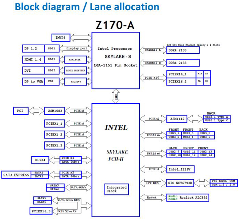

Here is the block diagram of z170 pro gaming for comparison:
