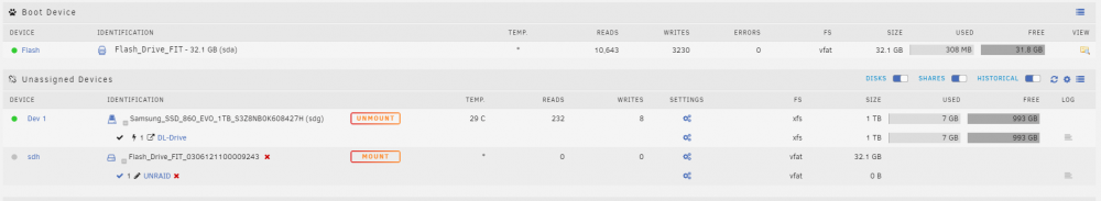

Additional: My flash boot device shows as it should in the main tab but when viewing files, there are no files. It does show size, used and free sizes unchanged however.

It looks as though your flash drive has dropped offline.
This has happened with 2 different Boot Devices. I thought the first was failing so I swapped out for a new and it keeps happening every time I add a Z Wave USB device. I've tried the Zooz and Aeotec. Both having the same effects.
