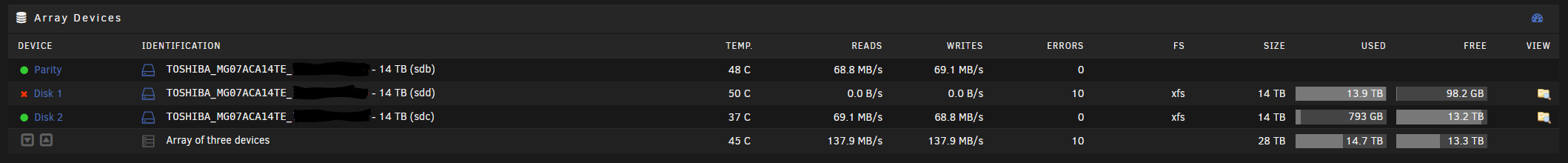

January 16, 20224 yr Author I shut the server down, checked the cables and started it again. The SMART data attributes look good, i think, and it says SMART overall-health:Passed. I also got a notification saying "array turned good" and it now shows 0 errors in the main tab. What do i do now? With the array started the disk is still disabled, do i have to initiate a rebuild to get the data back? Or should i start a "Check" as seen in the second image?
