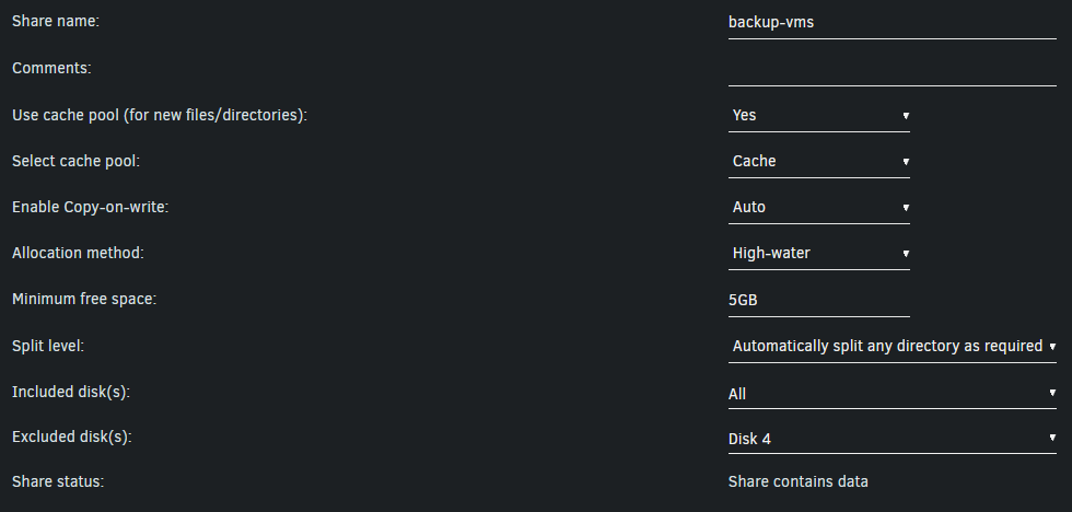

I have a proxmox server, and an unraid server. The proxmox server makes nightly backups to the unraid server. It backs up to a share called "backup-vms". This share is set to "Yes:Cache"

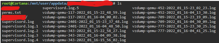

When I run the backup, it writes the backup files to my cache drive, as it should. However, it writes the files to a different share/directory than it should. It should be writing the files to "/mnt/user/backup-vms" however, it writes the files to "/mnt/user/appdata/'application'/".
I'm not sure what is happening here. If I ssh into the proxmox server and go to  "/mnt/pve/vmbackup-unraid" it points to that applications folder in my "appdata" share.
