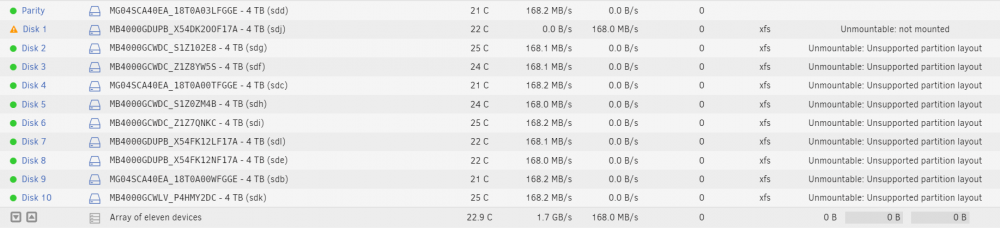

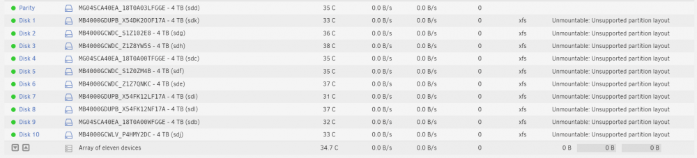

Unmountable: Unsupported partition layout Error After power outage. All my data is gone.
I was just setting up my server after it was off for a week, and this is what I see now. image.thumb.png.1dda86350b3b61be1f67cf81ef929ee1.png
I was in the process up updating some containers when my daughter, 18 months old, walked over and hit the power button on the UPS. I don't even know where to start on troubleshooting this. I have read through a bunch of other posts and nothing seems to fit my situation.

Looks like the sort of problems people have when they try to use RAID controllers with Unraid.
I think the solution is to get rid of the RAID controller, figure out your disks assignments without that controller in the system, then see if you can rebuild each data disk one at a time from parity.
Wait for additional opinions since I don't really have personal experience with this situation.
Unfortunately this won't really work for me. I have SAS drives and nothing in the retail space really uses SAS. I can keep troubleshooting that piece though.
Lots of people using SAS drives with Unraid. It is the RAID controller you need to get rid of, or at least flash it to IT mode.
I swapped out my Adaptec 71605 with an 8 port SATA card as and as I suspected I am no longer able to see my SAS drives. The controller is listed on the compatible list. https://wiki.unraid.net/Hardware_Compatibility I moved recently, and lost my second parity drive to failure when I booted everything back up. I also just moved it out of my server rack into a tower case. In doing so I lost the capability to use a backplane. I will go back through and test every setting on the controller and see if I can get it to work again.

Well I ordered a 24 port LSI card. It will be here Wednesday. I will be extremely sad if I can’t salvage any of the data. This NAS has 15 years of data stored on it.
Recently one user with the same controller found it overwrote the first few sectors of every disk destroying the data after a firmware update, did you make any?
I did not make any updates to the controller.
Still likely the reason for the problem, depending on what/how much of the partitions was damaged data might still be recoverable, you can try this, assuming parity is still valid:
-Stop the array
-Unassign one of the data disks
-Start the array
-Post new diags
Unraid will recreate the partition, depending on what is missing/damaged on the other disks it might work or not, if the emulated disk mounts and contents look correct you can just rebuild the disk, then repeat for the other ones, one at a time.

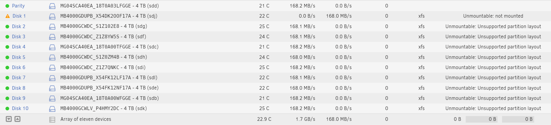

Here are the new Diags.
tower-diagnostics-20220118-0823.zip
Additionally it looks like it may still have all the data there, but I will need to rebuild each disk one at a time?
Diags are before array start with the emulated disk, so can't see if a valid filesystem was detected, try checking filesystem on that disk and/or post new diags, I mentioned rebuilding only if the emulated disk was mounting, not much point in rebuilding if the filesystem can't be fixed.
There was no filesystem found on the disk. I checked with Unassigned devises and was unable to mount the disk. All it kept saying was format.
Check filesystem on that disk, primary superblock could be gone but it might find a backup one, as long as just the first few sectors were wiped.

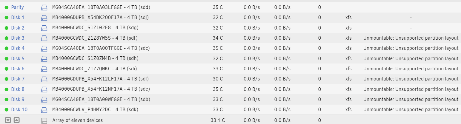

Ok so I finished running the repair and all the disks show this:
They all seem to be "repaired". But I am still having issues getting them to show up in the array. I am guessing the Array is working and good because I can remove a disk and rebuild it no problem, but I would like to get all of the working in one fell swoop vs rebuilding each disk one by one.
As you can see I rebuilt two of them and they seem to be fine, this screenshot was taken in maintenance mode. Any ideas from here?
tower-diagnostics-20220120-1405.zip

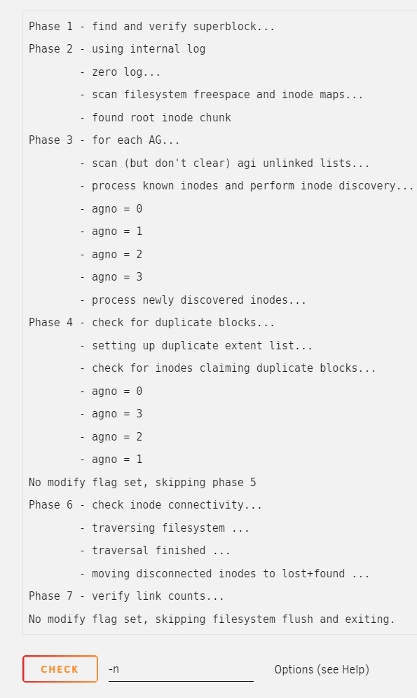

You checked them with the no modify flag (-n) so the check only found the problems it didn't fix them.

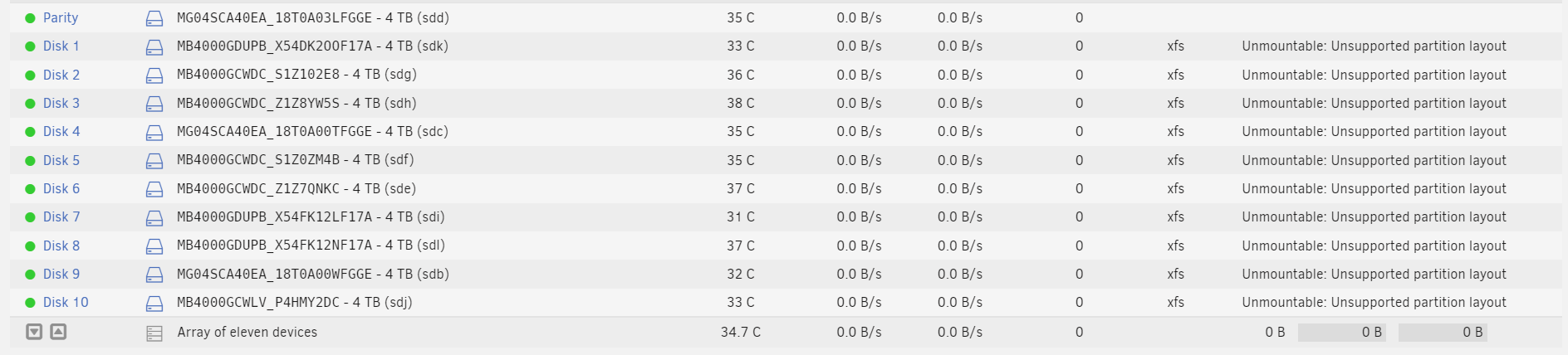

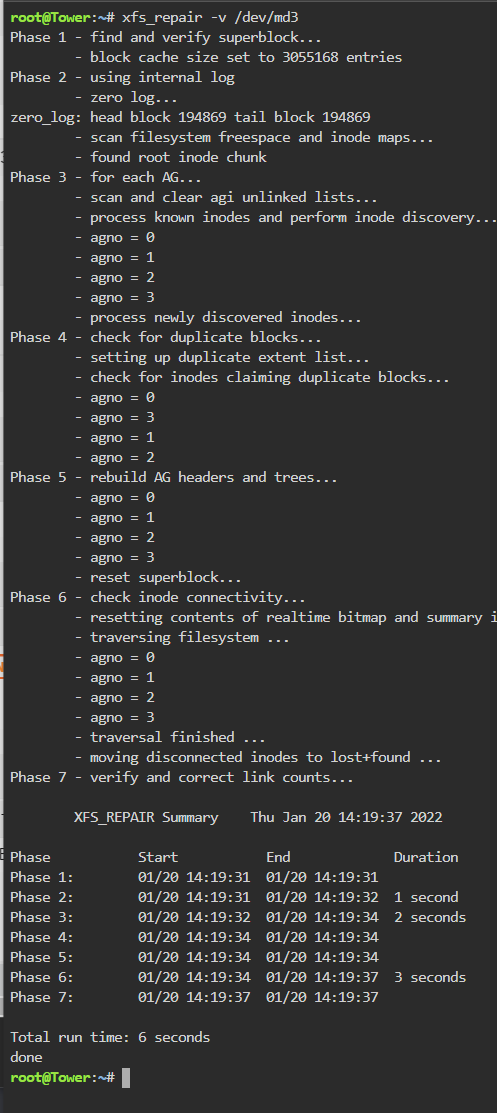

I repaired all of them, then rebooted, the. Took this screenshot moments ago. I used the info in the linked article to repair them from the console.
According to diags disks 1 and 2 mounted, or did you format them? Screenshot is maybe in maintenance mode?

Previous diags are after array stop, post new diags after array start in normal mode.
I rebuilt those disks by un-assigning them and the re-adding them.
Here is what I ran on all the disks and followed all the instructions. image.thumb.png.f737e5d18540fcd721a0a8f8f81b4ca3.png
I know, but initially they weren't mounting, as the screenshot you posted shows.
Please see attached.
