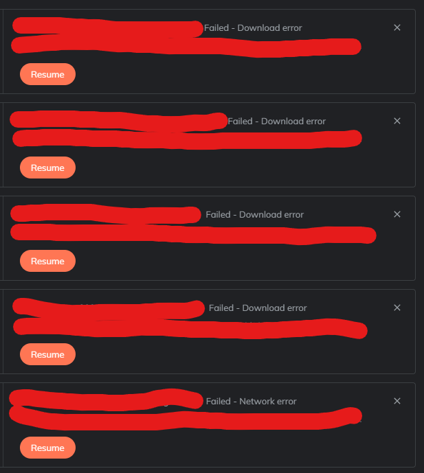

Which brings me to the issue. I noticed that when multiple downloads/transfers/reads are happening simultaneously, ALL downloads/transfers/reads stop simultaneous and give some sort of "network error" notice. Then I usually have to manually restart everything.
My only "solution" to this is to reduce the amount of downloads/transfers/reads at time, which is 1) inefficient for me, and 2) requires too much micromanagement from me going back and forth starting new downloads/transfers/reads.
I would really just prefer if i can just initiate all the downloads/transfers i need and let it rock on its own.
For example, on the Windows 10 VM, here are some lines from the qBittorrent execution log when this "network error" happens. These torrents will start, maybe get a bit of download progress, then all stop, and throw an error. (X:) is a mapped network drive for Downloads share, (Y:) is a mapped drive for Media share
1/17/2022 3:28 AM - Failed to move "xxxxx" from "X:\incomplete\" to "Y:\". Reason: xxxxx storage move failed. file_rename (X:\incomplete\xxxxx.mkv): Invalid argument.
1/17/2022 3:28 AM - File error alert. Torrent: "xxxxx". File: "X:\incomplete\xxxxx.mkv.!qB". Reason: xxxxx file_write (X:\incomplete\xxxxx.mkv.!qB) error: An unexpected network error occurred
And I've also attached a little screencap of attempting to download files via internet browser directly to the server.
