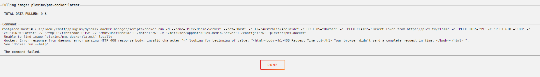

Can't install apps fails to pull
unraid was running fine one minute, then plex wasn't accessible form the outside network, sonar nzb etc all seem to work, nginx proxy manager for overseerr also stopped, nothing on the network was changed. I thought the modem was randomly blocking ports again, so I changed it. made no difference.

now I cant install the apps .

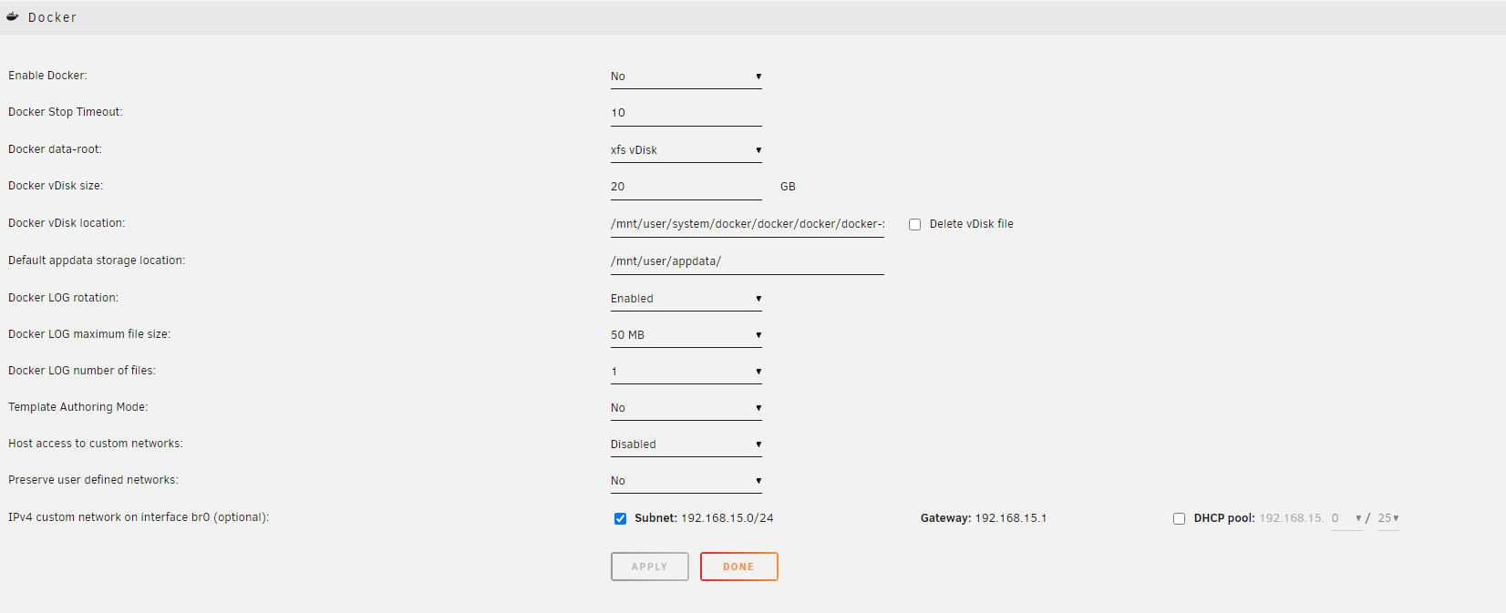

Do this as a test.  Settings - Docker.  Stop the service.
Change the image type from XFS to instead be btrfs (you're not going to lose the existing image / apps)
Restart the service and try installing something.

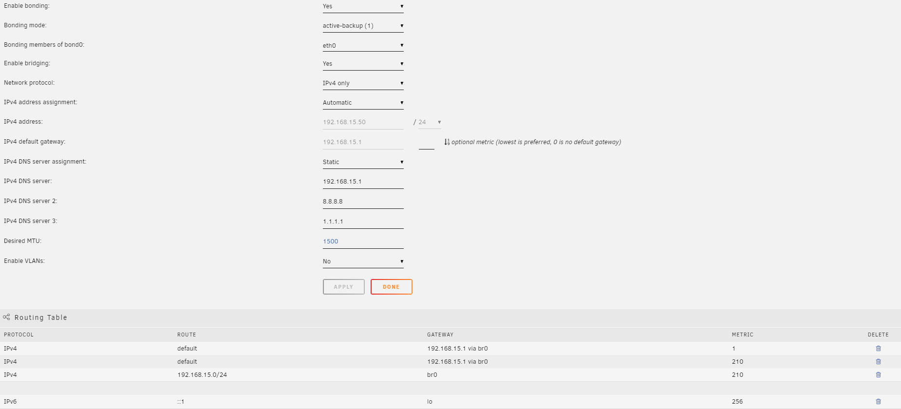

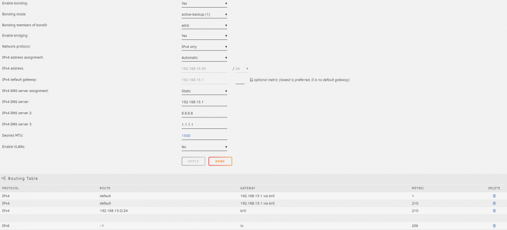

any of the settings in the attached images wrong? yeah there is default bro field twice, ried adding with lower metric number for testing
OK, so something really strange is happening, I can download apps that are from linuxservers , I tried several others from different repository's and they fail.
an update:
I plugged into another internet connection and I can downloads apps without an issue, plug back into mine and nothing.
So maybe the ISP blocked stuff?
Yeah, it's something weird happening there.  They're letting requests go through to github (lsio's lscr.io which mirrors back to ghcr) but blocking access to dockerHub itself.  (Or its your modem doing this)
