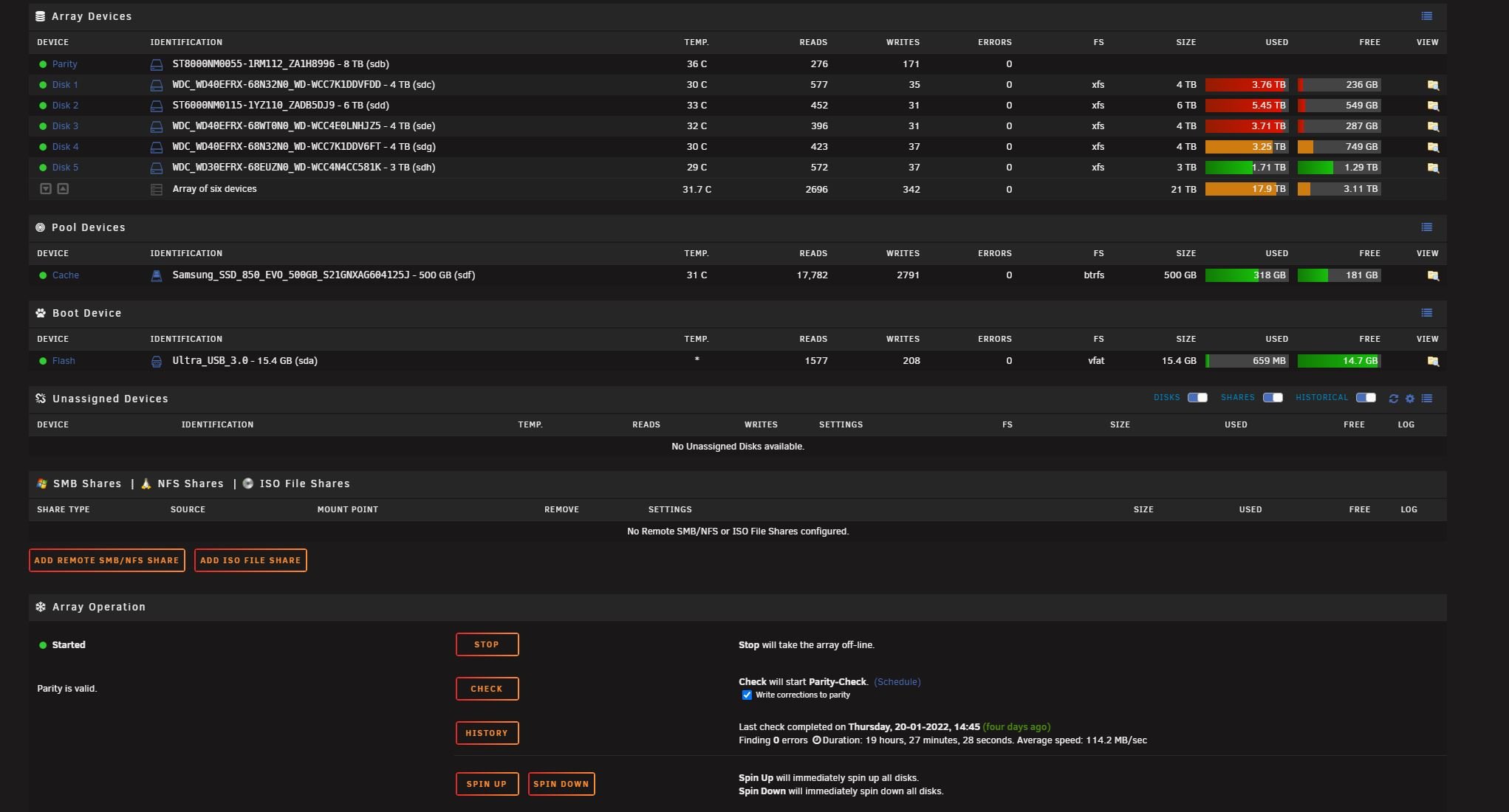

SMART for parity looks OK and parity sync had been proceeding for several hours without further I/O errors.
Yes, it has 3 hrs to go and so far all is fine. 0 errors on ANY drive.

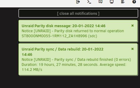

OK... so the Parity check finished. As expected, it came out error free.
I have attached a fresh diagnostic for your perusal.

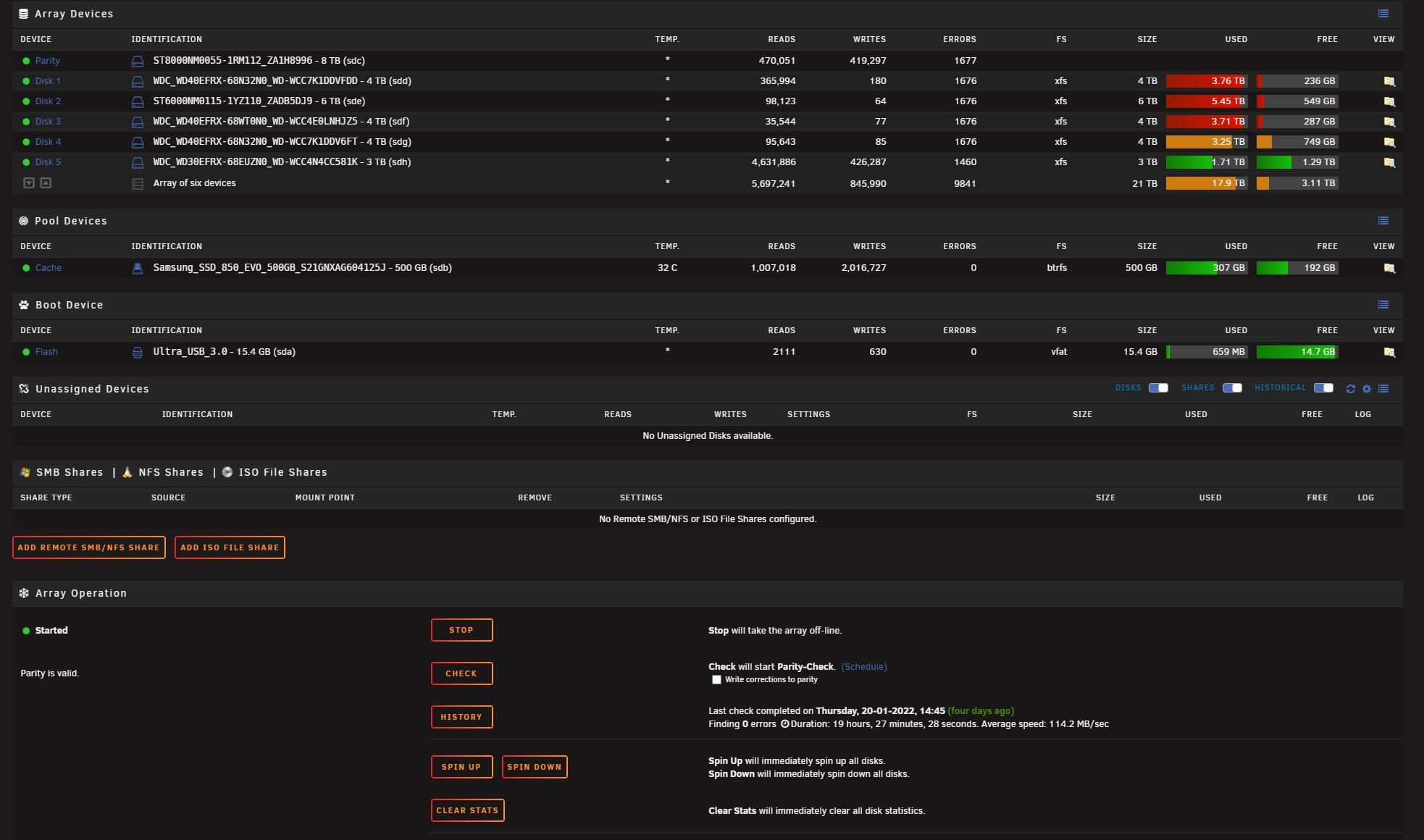

Good evening....
As I expected, it happened again.
Haven't touched the array since doing the parity check the other day.... ie: haven't installed or messed with it.
I just logged in and was greeted with the errors :(
I have attached the diagnostics of the current situation.

btw, I just noticed that there is no temperature readouts since the error messages have popped up!!!
Also, I noticed the parity drive didn't change to the orange triangle. I did a simple shutdown and restarted the array up again and it was back to normal!
No idea why the errors are being posted in the first place!
Edited by mort78
Problem with the HBA:
Jan 24 09:33:38 unRaid kernel: mpt3sas_cm0: SAS host is non-operational !!!!
Make sure it's well seated and sufficiently cooled, you can also try a different PCIe slot if available, failing that try a different HBA.
