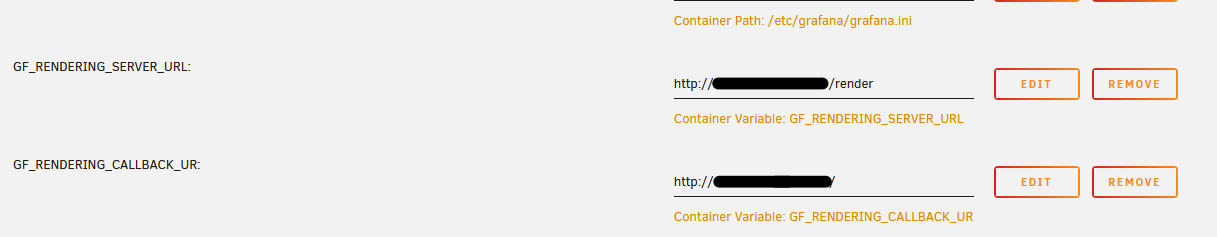

On 11/2/2022 at 1:01 PM, Curtis777 said:
Thanks for the plugin,
is this in unraid a Variable or Label ?
can you show an example Screen for me please ?
You have to add those variables to the Grafana Docker Container in unraid:

18 hours ago, assembled-prejudice1822 said:
Hello,
How to setup Grafana (docker in Unraid) after I have installed this docker ?
Thank you !
Franck
You already have the answer in the description of the template:
Read Grafana Image Renderer documentation and see usage instructions at readme link.
In order to use this as a plugin of your Grafana docker instance you must add this enviromental arguments to that container:
- GF_RENDERING_SERVER_URL: http://renderer-ip:8081/render
- GF_RENDERING_CALLBACK_URL: http://grafana-ip:3000/
Change the IP (and the ports) to suit your configuration.
