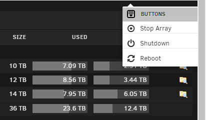

I sued the Reboot Option from the menu.  When the server came back up I got an "Unclean Shutdown" and it started a parity check. What Gives?  Am I not supposed to use this option?
