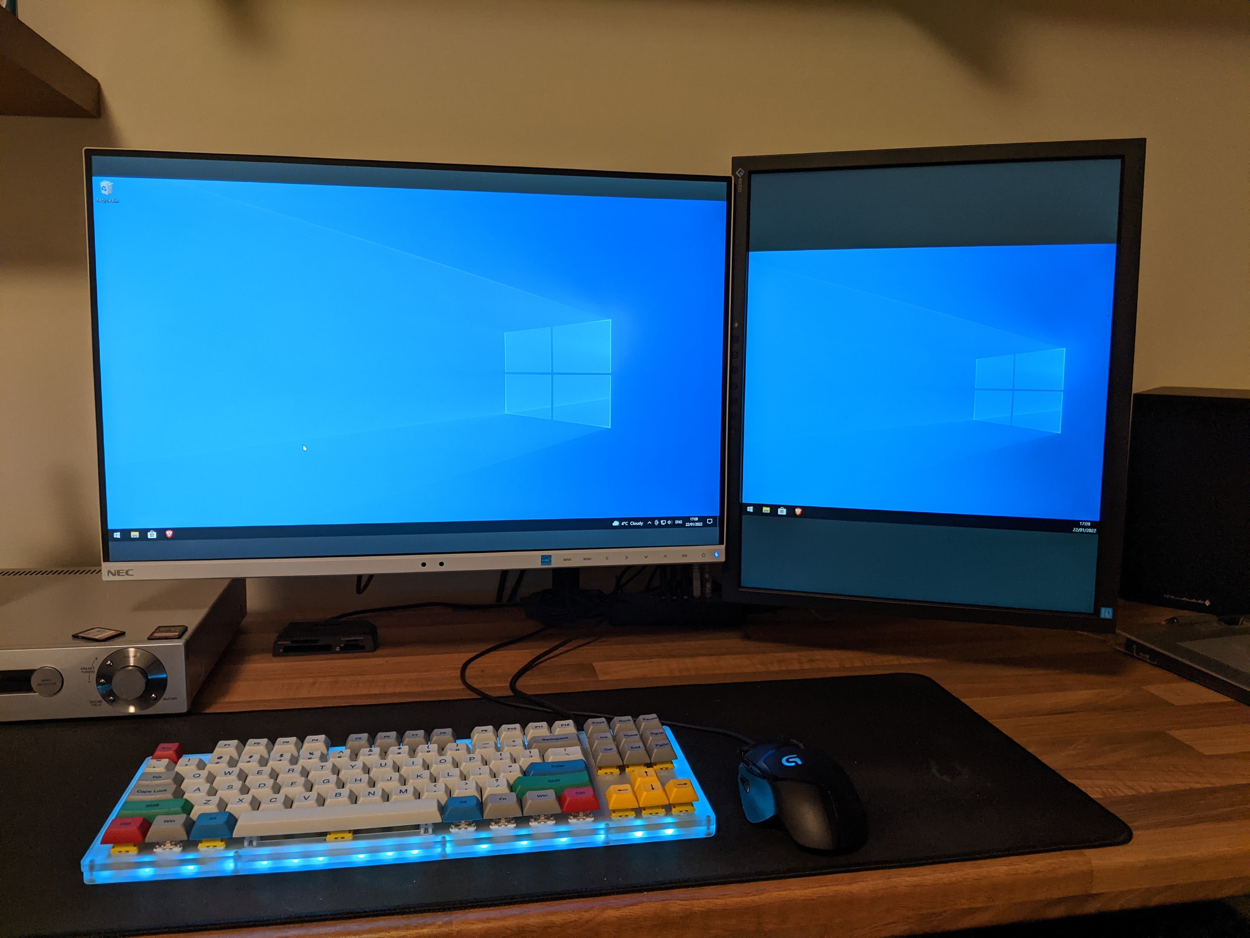

Thanks for taking an interest. I'm basically following the guide here:
as this is the only suggestion I have found so far.
I set it up with a Spice server and two Video QXLs, then run "remote-viewer spice://localhost:5900" in a terminal.
Unfortunately, the end result looks like the attached.

So the issue is that the screen on the right doesn't "rotate"?
Stupid question: don't you have some settings in the windows guest to adjust that display, like setting the portrait mode?
:D Ha, no. I mean, yes they are there, but the only result of putting it portrait is now the screen is sideways! None of that helps at all, alas.
Could be an issue with the qxl driver, but unfortunately I can't test this config and I can't find anything useful in google.
Also the first monitor in landscape doesn't seem to adjust in a proper fullscreen.
