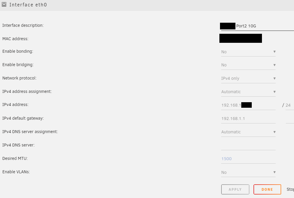

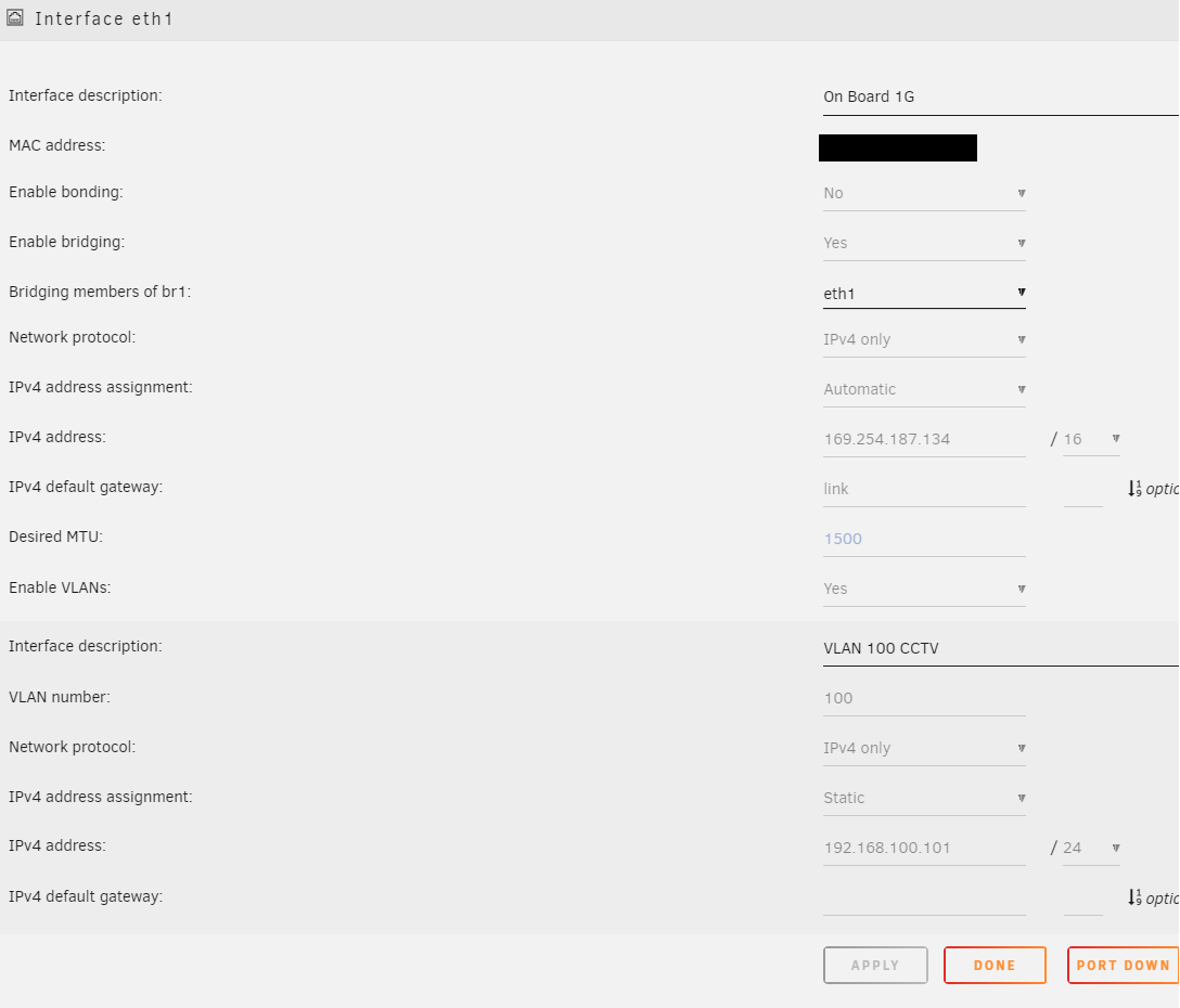

See below screenshots of 2 ethernet physical connections in UNRAID.
Objective is to install Shinobi docker for CCTV on separate VLAN that should not have access to array data or mgt interfaces.
  • et0 10G NIC is intended for UNRAID array sharing only. Working OK.
  • eth1 1G MB NIC is intended for Shinobi VLAN bridge. CCTV cameras on that VLAN should not have access to eth0 and array.
    • Bridging has been enabled for eth1 and CCTV VLAN 100
    • Switch has been configured to isolate eth1 physical from 192.168.1.1/24. That's why eth1 is not able to talk to router and gets automatic private IP address: 169.254.187.134
Please help me review Network Settings configuration:
Thanks!
