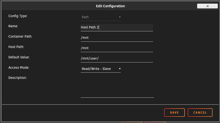

Thought I had Emby humming.  There always seems to be something else broken with Unraid.  I'm starting to wonder if Krusader is linked to many of the ailments.  I get crashes when Krusader is running.  I also got an error telling me that "Docker application Krusader has volumes being passed that are mounted by Unassigned Devices, but they are not mounted with the slave option"
I use Dolphin instead of Krusader but the concept is similar.  If you are passing a UD path to the docker container, it should be mounted in R/W Slave mode to avoid potential access issues.  In this example it is /mnt which is not a UD path, but you get the idea.

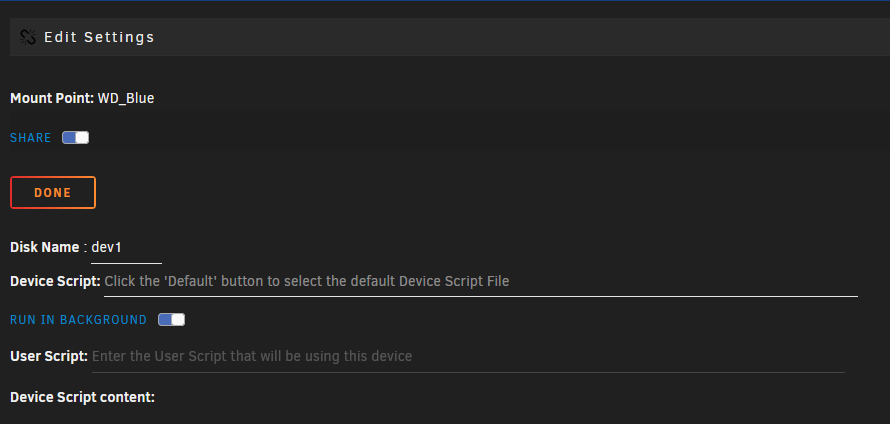

I'm still trying to find a work around where I don't have to be too familiar with linux command-line.  Right now I have access to my Array through a drive mapping on my Windows computer (this one).  Is there a way to also map a drive to an unassigned device, such as my external 14 TB USB-connected drive (dev 1)?  Then I could at least copy files easily through Windows from my Array to my backup external USB drive?
In the UD settings, you can share the device as if it were an unRAID user share.  It then shows up in Windows as a share under your server in Networks.  You could then map a drive to it if you wish.
Here are my settings for the "WD_Blue" UD device as an example.  I have no script associated with this one as it is mounted permanently but this would be where you set the script to run if you want to.
