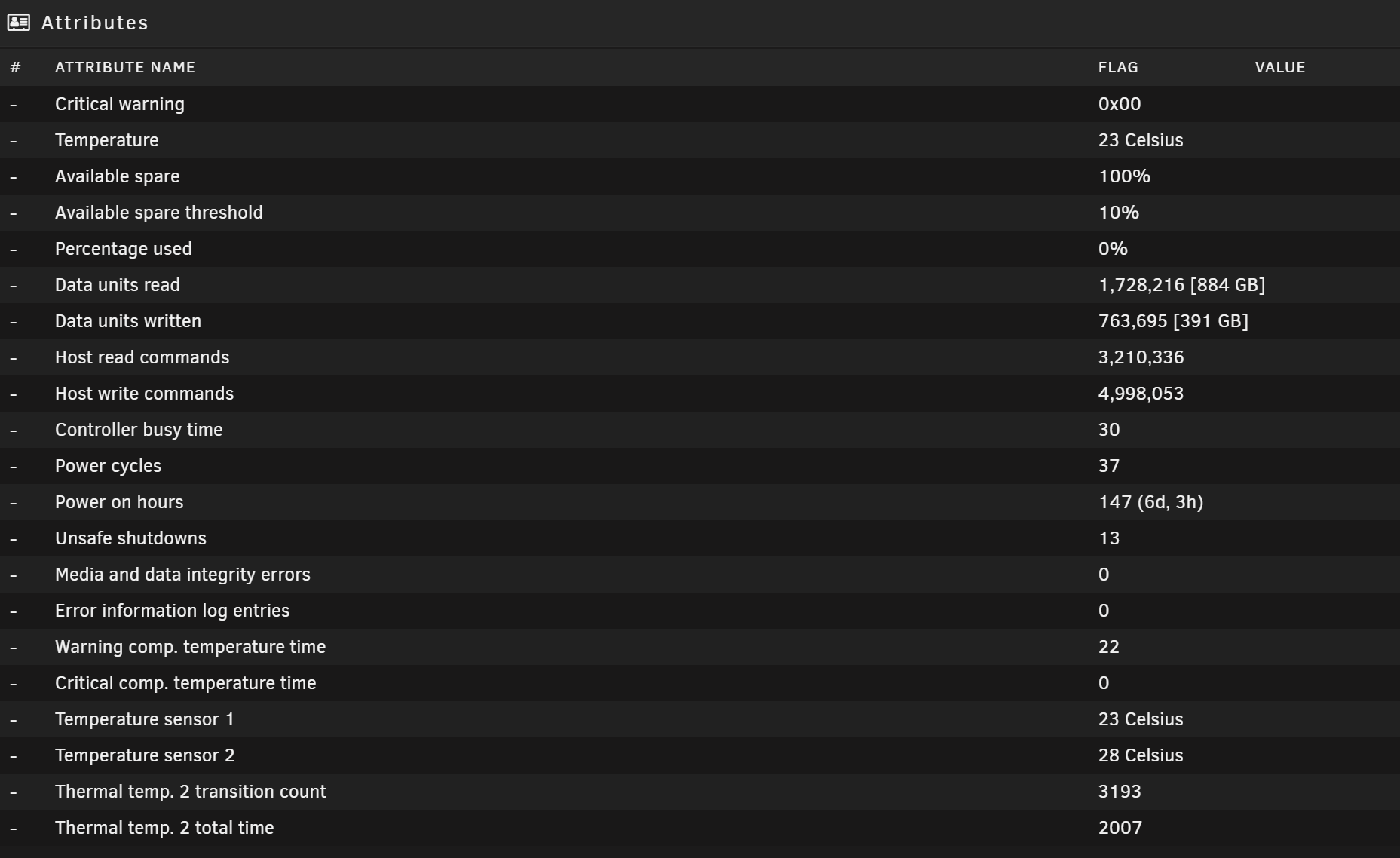

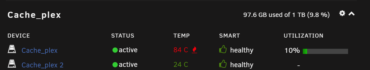

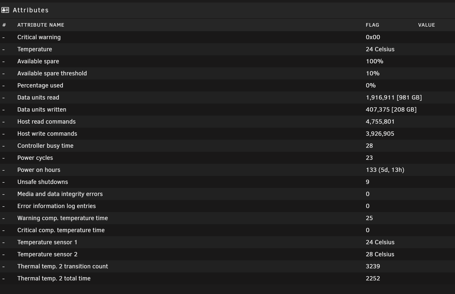

I have an NVME drive (nvme2n1) in raid 1 cache pool used for Plex only. The 2 drives are identical make and model (Samsung SSD 980 1 TB). 1 drive has reported overheat twice. The first time I was not home and could not monitor it. The second time was less than 1 hour ago reporting 84 degrees. Mover was not running and nobody was even watching Plex. However, there was 1 download happening at 21:14 for 1 minute. I got the overheat notice for 84 degrees at 21:16. I was looking at all different areas to find what was causing it. While doing that, I noticed that in the disk smart information, it was reporting the drive at 23 degrees all while still reporting 84 on the dashboard and the main screen. At first I thought the smart info was old info but after pressing F5 a few times, it updated to 24. As far as I can tell the temperature never deviated from 84 for the next half hour. Then at 21:47 the server reported the disk returned to normal temperature. It was now showing 26 on the dashboard. How could a drive drop almost 60 degrees in 30 minutes? I am attaching my diagnostics and screen shots of the temperatures. Thank you.

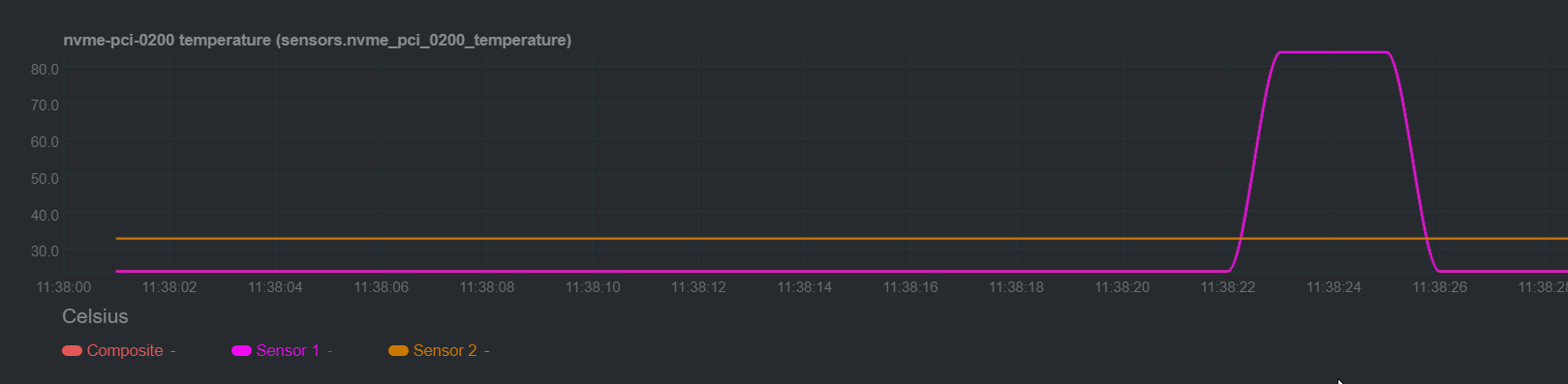

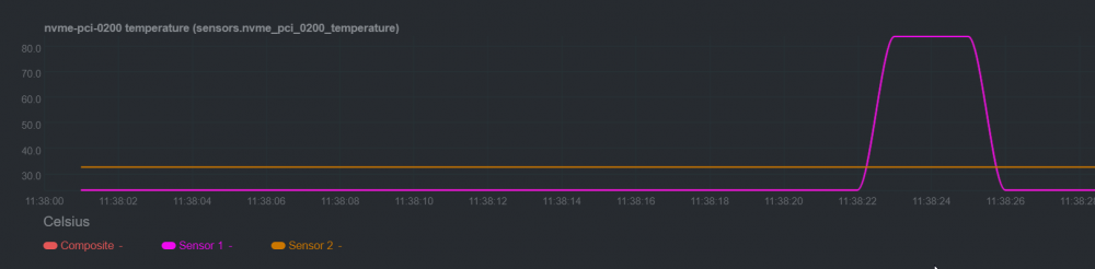

It lasts for 3 seconds. Now I know it is not for real. Temperature goes from 24 to 84 and back to 24 all within 5 seconds? Hmmmm.
btw this is the twin raid 1 drive (same make and model) to the 1 I mentioned above. Maybe a manufacturing defect?
Isn't the disk temperature going up that high?
As I explained before, Unraid polls the disk temperature and will only alarm if the disk is high at that time it polls (every 30 seconds by default).  It would have to hit in the 3 seconds time when it is high to cause an alarm.  Three seconds out of 30 minutes is not a very high probablility that Unraid would hit it.  A couple times a month explains that.

Definitely what looks like a firmware bug on the drive that primarily affects Linux systems across the board (and some Windows installations)
