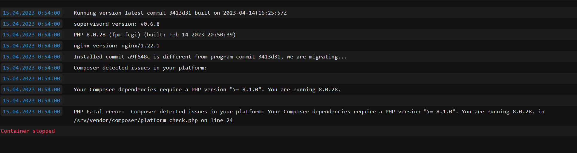

April 14, 20233 yr After latest Update Having Php error: image not customized by env build arguments ...
April 15, 20233 yr 17 hours ago, Masterwishx said: After latest Update Having Php error: image not customized by env build arguments ... same requires higher version of PHP to run
April 18, 20233 yr On 4/15/2023 at 7:11 PM, nktm85 said: same requires higher version of PHP to run Opened issue on github and author has fixed in v4.01

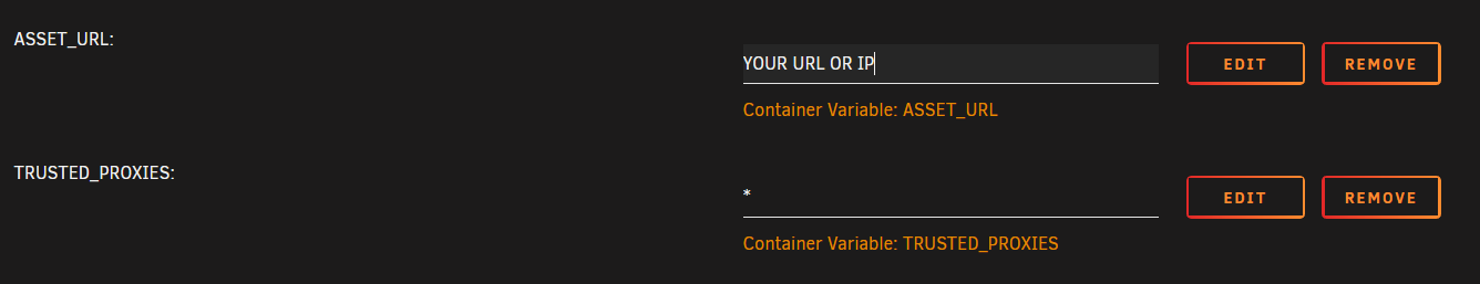

July 30, 20242 yr For anyone whose 2fauth app just loads a blank screen and SSL (via reverse proxy) not working correctly, I was able to fix by added two variables to the container: ASSET_URL: use your reverse proxy domain TRUSTED_PROXIES: with value * (I think because the app is loading assets from outside domain, you have to set this otherwise the SSL certificate will fail) This is on UNRAID: v6.12.4 2FAuth – v5.2.0 Reverse Proxy Docker: Swag
January 2, 20251 yr On 7/31/2024 at 12:31 AM, nktm85 said: For anyone whose 2fauth app just loads a blank screen and SSL (via reverse proxy) not working correctly, I was able to fix by added two variables to the container: ASSET_URL: use your reverse proxy domain TRUSTED_PROXIES: with value * (I think because the app is loading assets from outside domain, you have to set this otherwise the SSL certificate will fail) This is on UNRAID: v6.12.4 2FAuth – v5.2.0 Reverse Proxy Docker: Swag I just wanted to thank you, because I really needed this! It worked perfectly.
