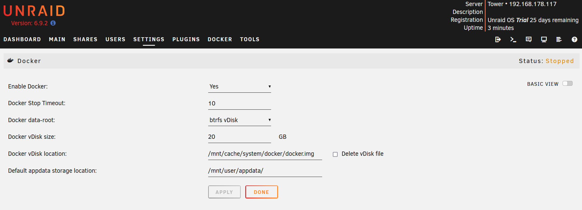

Also, while not the cause of your problems, the way you are configuring docker in Settings is not ideal.
Though not technically wrong, the "standard" path for docker.img is in the system share, and the "standard" path for appdata is in the appdata share. If you go against the standard, you will have to pay close attention since other things you try to do may expect those standards.
Regardless of which paths you use, ideally, docker.img and appdata should be on fast storage (cache) and configured to stay there. If these are on the array, then dockers won't perform as well due to slower parity array, and array disks can't spindown since these files are always open.
Apreciated your tips.
reconfigured in the way you mentioned

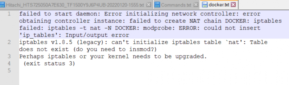

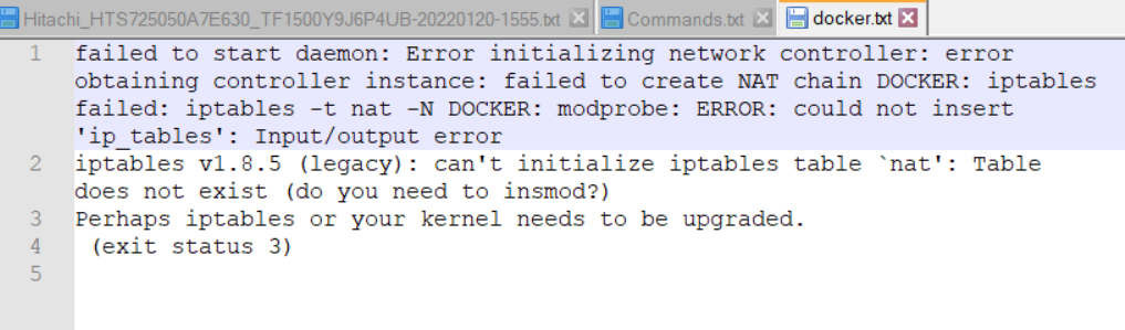

But look at this, I have seen in docker.txt file following network issues.
Maybe these info is helpfull also to identify the root cause
