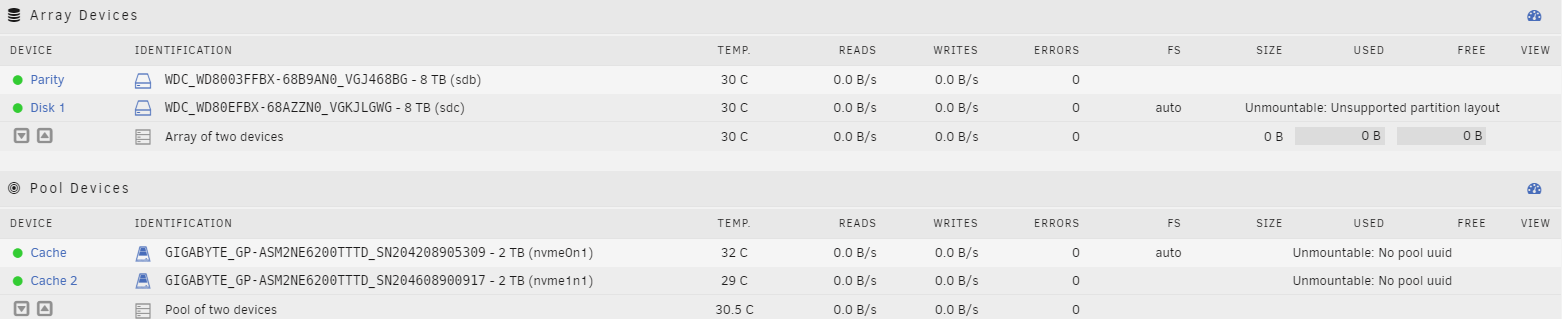

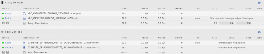

another strange thing is, that my disks (from array) are shown as "Unmountable disks present":
something wrong with format of the drives (i thought unraid formats them automatically to XFS? at creation of the array?
what does "auto" mean?

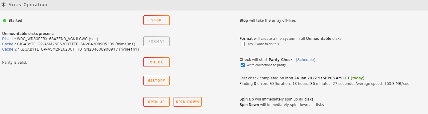

You need to format the assigned devices before use, next to array start/stop button.
i would bring up at least 1 message at initial setup of the array, i think many of new unraid users will make this kind of "error"...
