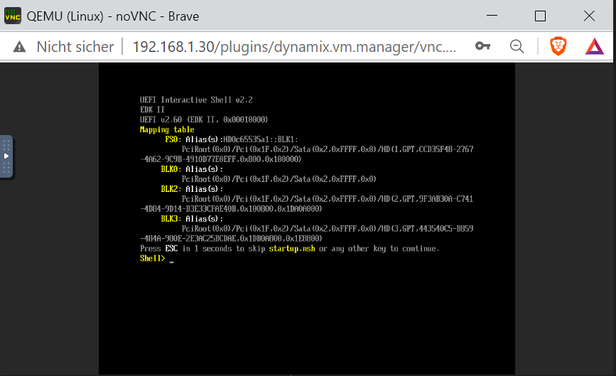

I've been trying to get my Kali Linux installation running as a VM in Unraid.
I have installed a basic installation on a NVME which boots on startup without any problems.(Without Unraid)
But every time I try setting up a VM I get stuck with different issues depending on my settings.

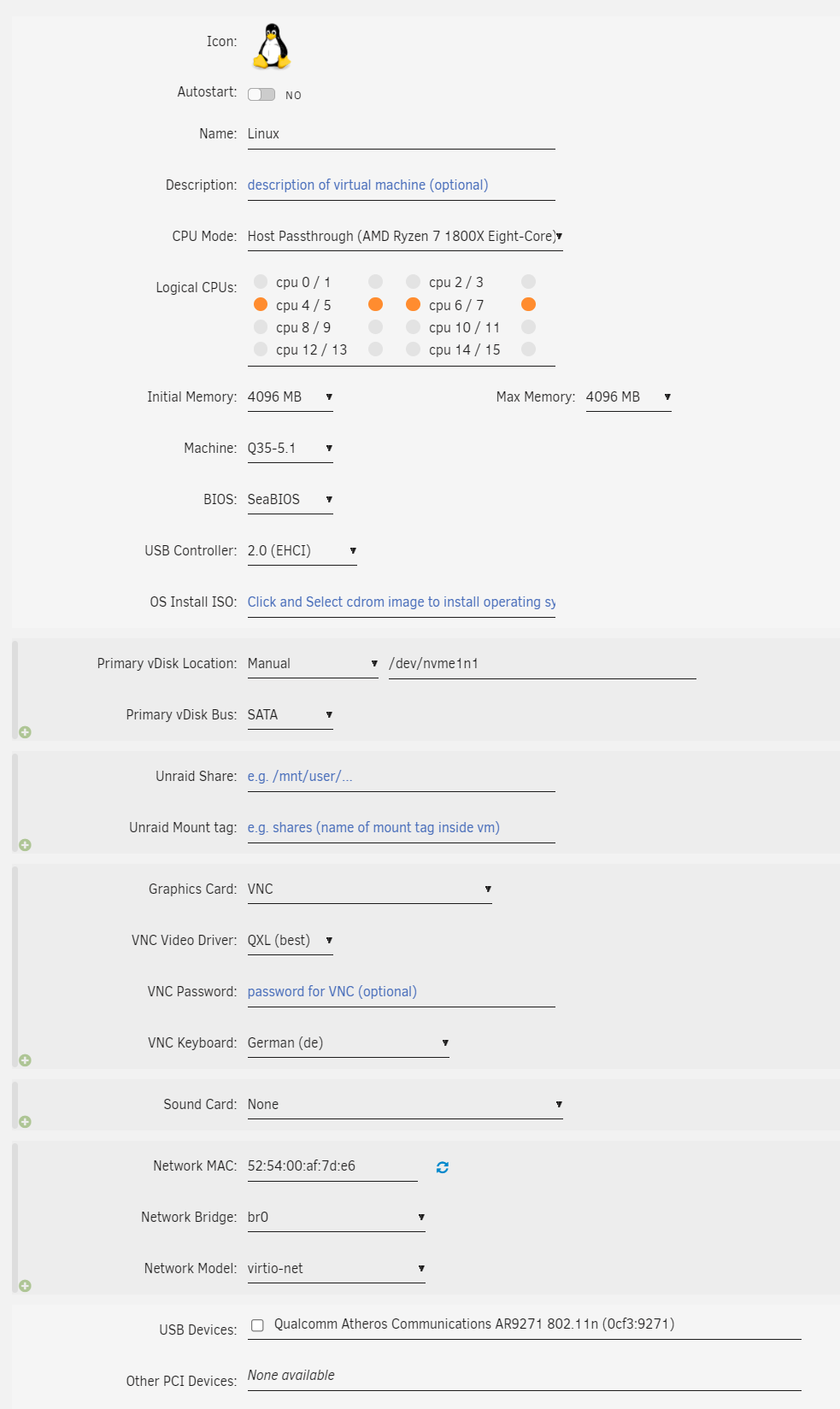

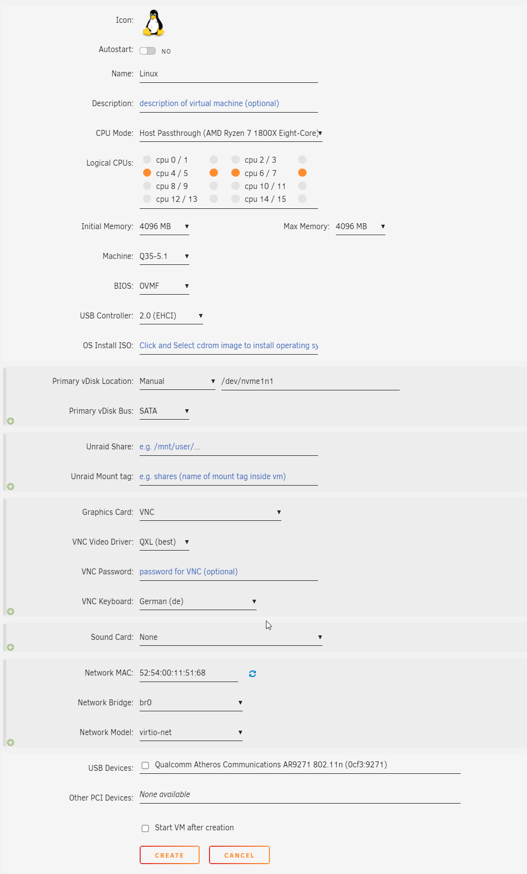

First setup:
With these setting I get stuck here:

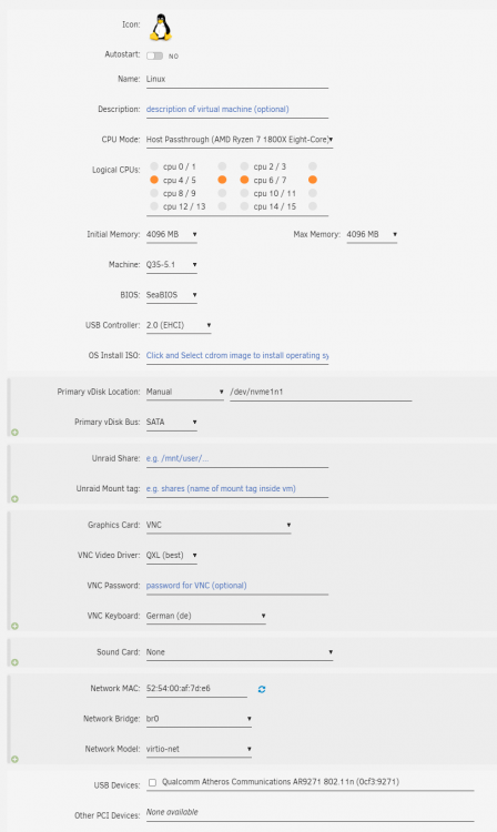

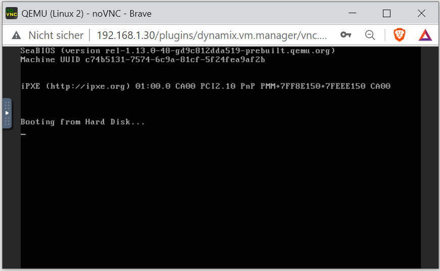

And if I try the SeaBIOS
I get stuck here:
What am I doing wrong?

First settings are correct: q35+ovmf (you have fs0 on hd).
You need to create a custom entry in ovmf.
Start the vm and press esc to boot into the ovmf bios settings, create a new entry for boot, point it to the efi file, adjust boot order, save and reboot.

Sorry for the noob question but what do you mean by "you have fs0 on hd"?
In the screenshot you posted you have the map of your drives and you see FS0, that is the partition which most probably contains the EFI folder with the .efi payload.

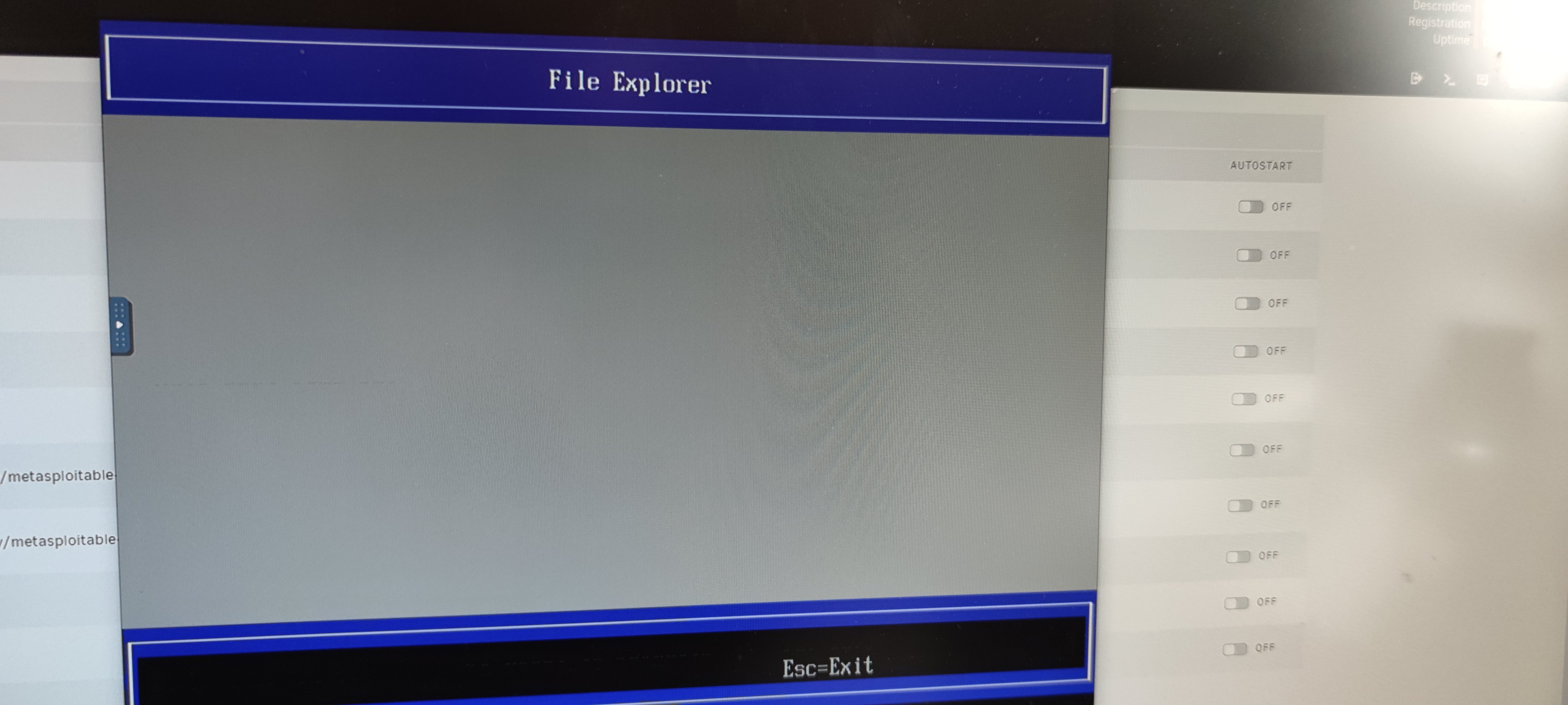

Maybe allow me to ask another question regarding this topic.

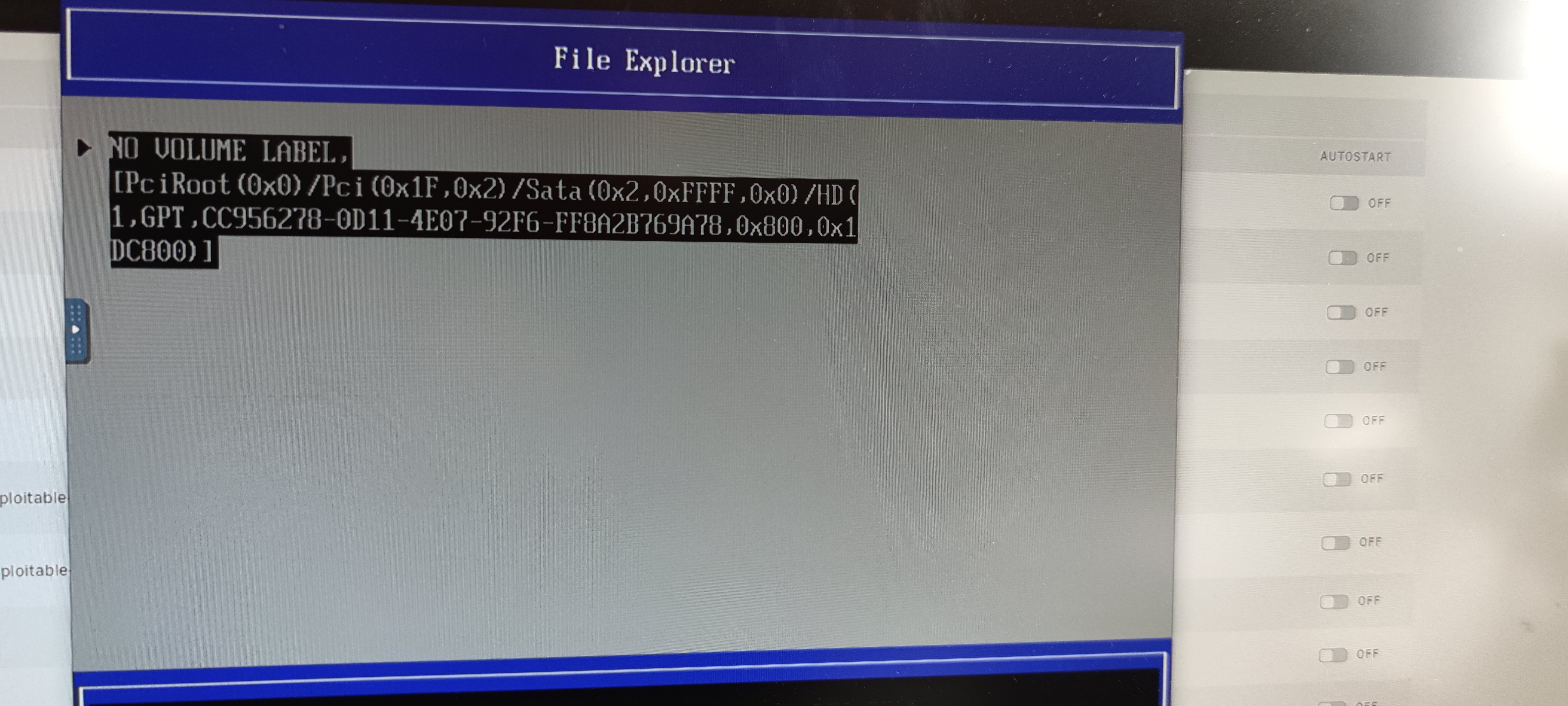

After your help, I thought I set up a new installation with encryption and lvm.
After setting up the partitions and installing the system, I went into the boot menu like before, but this time the .efi file did not show up.
It did not show any file system at all.
I only encrypted the root and the swap partitions, not the efi nor the boot partition.
What did I do wrong?
I have zero experience with encryption/lvm, I don't think the issue is related to this; did you create (manually or automatically) the efi partition and installed grub on it?
I created them manually because efi and boot partition are too small when created automatically. If the old kernels are not deleted after an update, it can cause some problems I've heard. And resizing later can be difficult. I can retry the installation and see if it works with automated partitioning... I will report back
I tried it again with automated partitioning - same issue. No file system is showing up.

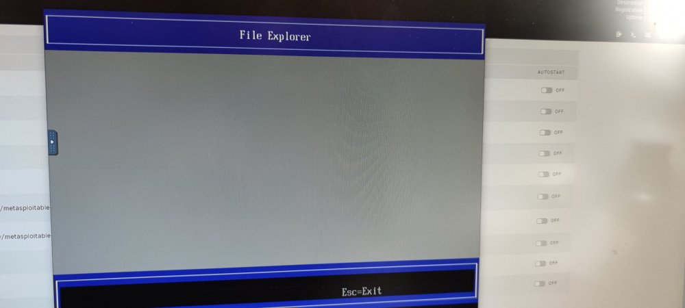

As for your question, I didn't get any error. It shows the same shell on startup and if I go into the BIOS and try to set up the boot-option with the efi-file it shows a blank screen after selecting the device:
Again, when I boot into this system without unraid it works fine.

This helps, so we know that the setup is correct.
I then suspect is an ovmf bios issue: I don't know what version of ovmf unraid includes, you can try the attached ones, save them somewhere and point the paths in the xml of the vm of OVMF_VARS.fd and OVMF_CODE.fd to these new files.
