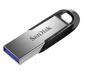

For what its worth, I've provisioned another 2 Unraid licences on Sandisk Ultra Flair (USB3.0) with zero problems for last couple of weeks.
I had one of those running for 3 years with no issues.  I just replaced it as part of my new server build.
