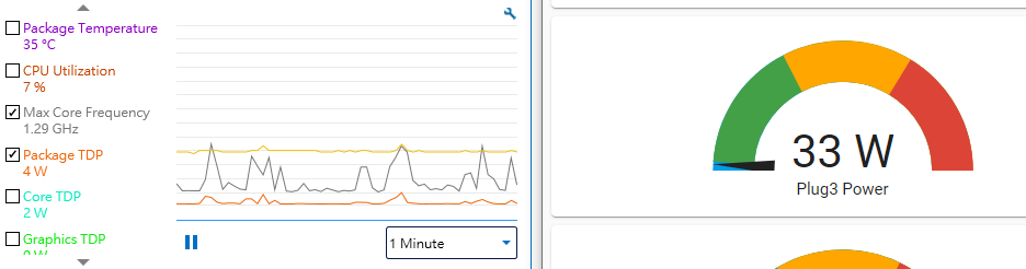

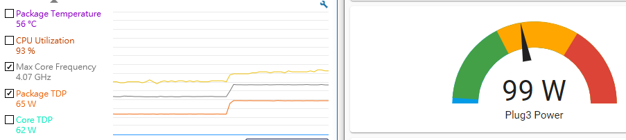

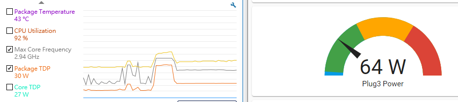

Below are some setting result FYR, it is 9700K ITX Windows build, they are Intel_XTU and smart plug reading ( whole system power draw )
Idle
PL1=30w, full load
PL1=65w, full load
