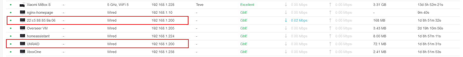

January 25, 20224 yr Hello, my router tells me i have 2 devices using the same ip. the ip is used by unraid server. I can't find the other one. arp -a on a lan host return unraid ip with an unknown mac address. I can see the mac address in unraid with ip link and it's attached to shim-br0@br0 i use one physical interface i have only one vm running with a different mac address. I have dockers running and one has a different ip (heimdall) what can be this mysterious device? edit: from my understanding, considering the interface shim-br0@br0 it should be a docker on custom network but i can't find it Edited January 25, 20224 yr by caplam
February 28, 20224 yr Author up! the problem is still present and i wonder if that's why transfer speeds with smb to macos is pretty damn slow (40min to transfer 5Gb) the mac address detected by the router are the physical adress of the adapter and a mac that seems tied to docker. 289: shim-br0@br0: <BROADCAST,MULTICAST,UP,LOWER_UP> mtu 1500 qdisc noqueue state UP mode DEFAULT group default qlen 1000 link/ether 46:8a:aa:36:26:bf brd ff:ff:ff:ff:ff:ff notice : the address has changed since my last post

November 14, 20223 yr From what I can work out, with Docker setup to Host Access to custom networks, you get a second network appearing on the same Server IP address. I have 2 NICS, one for the docker vlan one for the server management, both show two networks/MAC addresses at the same IP. Hasn't degregaded performance. What would be nice, and I'm not sure if possible, is to fix/lock a MAC address in for br0 so that my network controller can label it properly. It seems to change at every reboot. It's not a performance thing or show stopper, just helps my OCD cope with my network controller better.
January 19, 20233 yr I have the same issue. I keep getting notifications from unifi controller that there are duplicate IP addresses on my network. Upon checking it it is the shim-br0 interface that is using the same IP address as unraid. I want to know if there is a way to get rid of this as disabling the notifications on this warning is not a solution for me!
January 31, 20233 yr Also having the same issue with notifications from my UDM controller. The mac addresses are different. If I _block_ one, access to unraid is blocked.
January 31, 20233 yr disable the docker service and turn on advanced view. Check to see if you have the following enabled. "Host access to custom networks:" I also had this problem and after some searching it was advised to disable this option.
October 18, 20233 yr On 1/31/2023 at 4:51 PM, robw83 said: disable the docker service and turn on advanced view. Check to see if you have the following enabled. "Host access to custom networks:" I also had this problem and after some searching it was advised to disable this option. Thank you, I was just looking for this answer!
