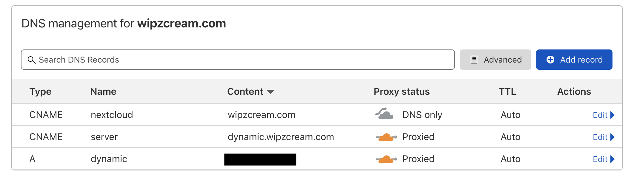

I am very newbie for unraid and I try to install Nextcloud by followed 2 of SpaceivanderOne videos as shown in the two links below:
1.
2.

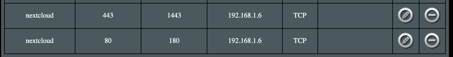

and I buy a domain from Cloudflare and follow the VDO until Forward port on my Asus router and why I don't have CNAME: WWW and CNAME: _domainconnect  as same as the VDO, Is it need ?
93977799_ScreenShot2565-01-25at22_08_02.thumb.png.4a3c620860bcd38c0c4845df62417a97.png
413157094_ScreenShot2565-01-25at22_06_54.thumb.png.9939bfdf30d6feb03ac5b27f248d974e.png

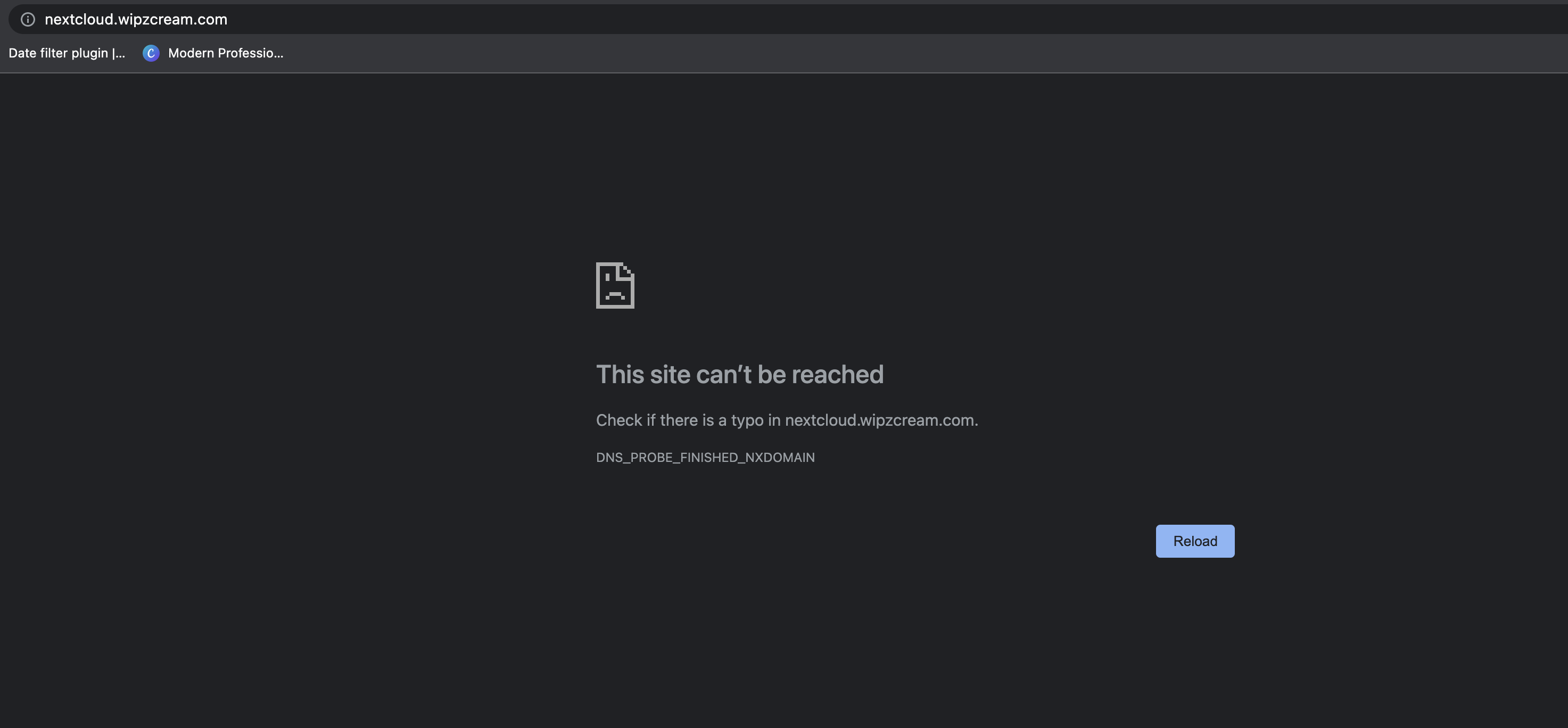

when I connect nextcloud.wipzcream.com on url it show nothing
949924997_ScreenShot2565-01-25at22_26_22.thumb.png.6f040b2d68c1b053afdc197a3ce0c6a2.png
What should I do ?
P.S. My public ip is static ip

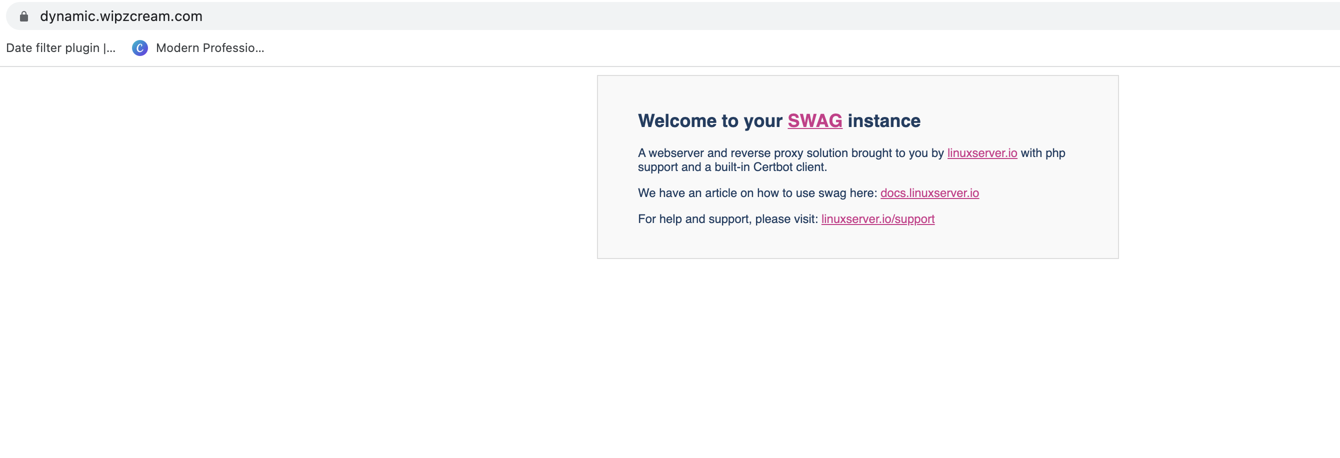

Solved by wipzcream

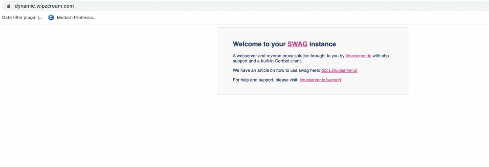

if i use dynamic.wipzcream.com it work
1298616168_ScreenShot2565-01-26at13_36_49.thumb.png.185f858fa8d9febedfa6c95a3de98e60.png
I'm far from being expert but i think your dns declaration is wrong.
you should use: CNAME Nextcloud dynamix.wipzcream.com
you have assigned ip to dynamic.wipzcream.com so cname declarations should match this name for others subdomains.

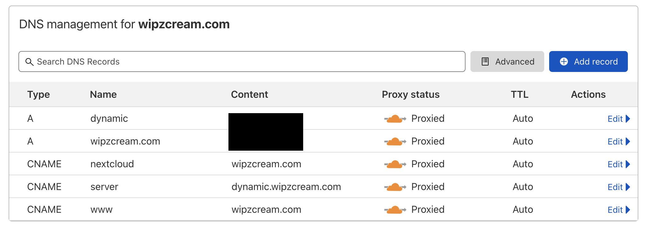

you have no A record.
From my understanding you should at least have :
A wipzcream.com "your ip"
CNAME nextcloud.wipzcream.com wipzcream.com
and others depending on what others servers you may have.
edit: i don't know how it works with your registrar but with mine A and CNAME records have to be with the complete subdomain name.

I add CNAME and A on cloudflare like this
217516761_ScreenShot2565-01-26at18_40_30.thumb.png.adeb35f107867db3ff072877a724ff20.png
and check dns lookup
A Records :
[0] Name : wipzcream.com | ttl: 300 | ip: 172.67.213.147
[1] Name : wipzcream.com | ttl: 300 | ip: 104.21.45.114
AAAA Records :
[0] Name : wipzcream.com | ttl: 300 | ip: 2606:4700:3033::ac43:d593
[1] Name : wipzcream.com | ttl: 300 | ip: 2606:4700:3030::6815:2d72
CNAME Records: None
MX Records: None
NS Records :
[0] Name : wipzcream.com | ttl: 86400 | value: javier.ns.cloudflare.com.
[1] Name : wipzcream.com | ttl: 86400 | value: ollie.ns.cloudflare.com.
PTR Records: None
SRV Records: None
SOA Records :
[0] Name : wipzcream.com | ttl: 3600 | mname: javier.ns.cloudflare.com. | rname: dns.cloudflare.com.
TXT Records: None
CAA Records: None
DS Records: None
DNSKEY Records :
[0] Name : wipzcream.com | ttl: 3600 | algorithm_id: 13 | protocol: 3 | type: KSK | key_id: 2371 | key: "mdsswUyr3DPW132mOi8V9xESWE8jTo0dxCjjnopKl+Gq
JxpVXckHAeF+KkxLbxILfDLUT0rAK9iUzy1L53eKGQ=="
[1] Name : wipzcream.com | ttl: 3600 | algorithm_id: 13 | protocol: 3 | type: ZSK | key_id: 34505 | key: "oJMRESz5E4gYzS/q6XDrvU1qMPYIjCWzJaOau8XNEZeq
CYKD5ar0IRd8KqXXFJkqmVfRvMGPmM1x8fGAa2XhSA=="

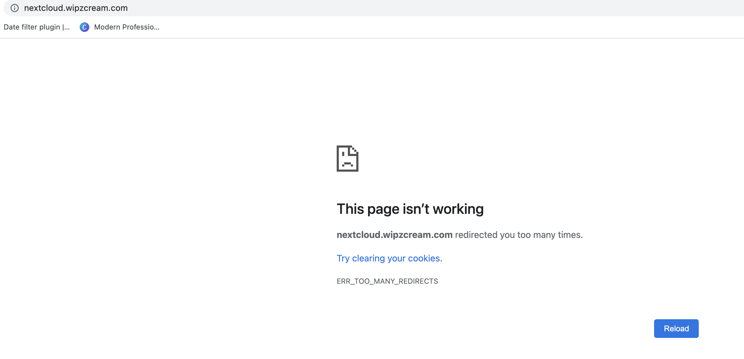

and I connect nextcloud.wipzcream.com and dynamic.wipzcream.com it show "This page isn’t working, ERR_TOO_MANY_REDIRECTS"  I clear cookie many time and restart my router it not working. I will wait until 24 hour and connect again I will let you know
thank you for your help
