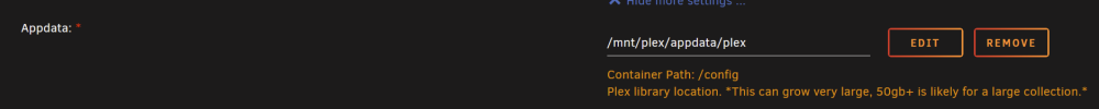

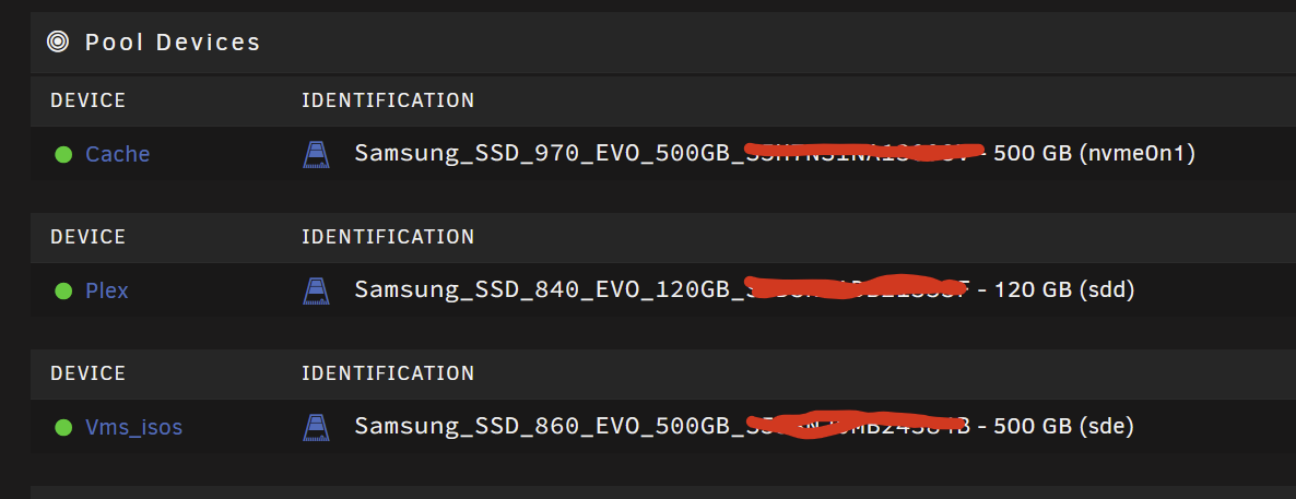

I do exactly this.  I have a pool SSD dedicated to Plex data with all other docker container appdata on the "cache" pool SSD.
I just set the appdata path in the Plex docker like this:
The other docker containers just use the default appdata path specified in Settings --> Docker:
Thanks, easy. That's how I have been running things on truenas.
