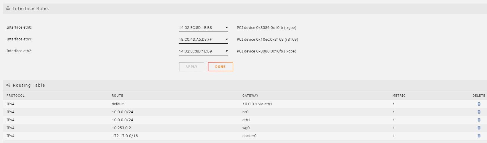

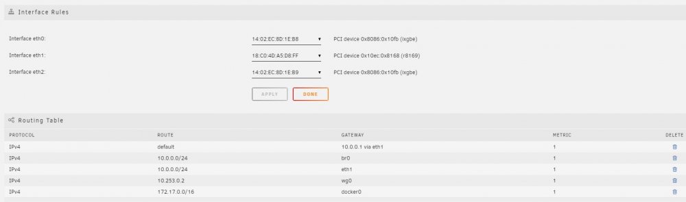

1gb.thumb.JPG.061711624b5b50bbf03e8cada33fc9a8.JPGtable.thumb.JPG.cd2466a99396219f314aaac6d88ed8b4.JPG10gb.thumb.JPG.0f967529f78408091d1533bb15cdd21a.JPG

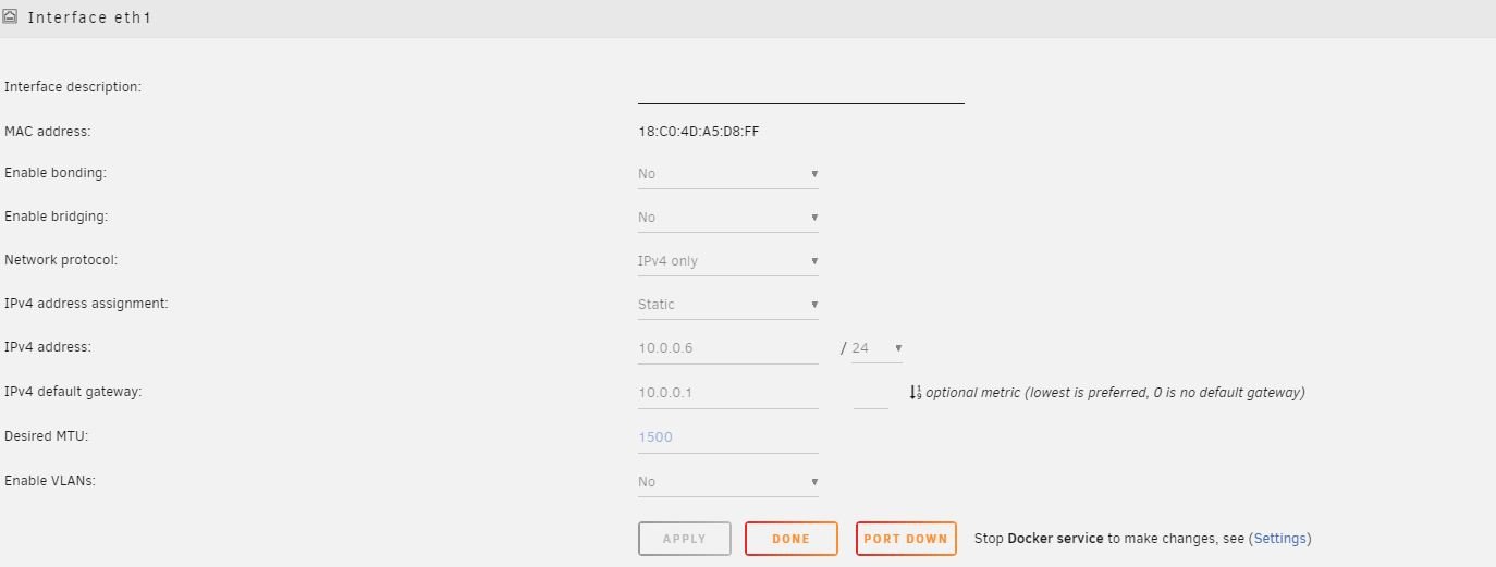

Eth1 is disabled on the switch port.

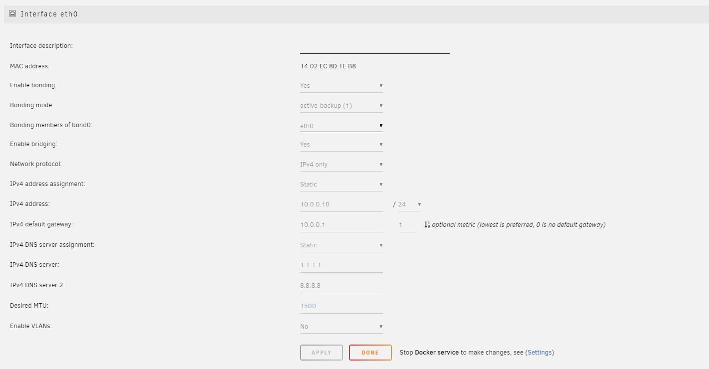

What I ideally want to do is turn bonding off on eth0 and just use the 10gb, but every time I turn off bonding I lose connection and can't ping the server.
First make sure your 10G interface is set as eth0, see Interface rules.
You need to reboot when interface assignments are changed, after that you can disable bonding and start using eth0 as a single interface.
Yeah, I have the 10gb interface set to eth0 and restarted the server, see the pics above, the pics are in the wrong order lol
the 10gb interface is MAC ending B8 and the 1g is ending FF.
Currently I have bonding disabled and can't access it, only way I can get access now is to enable eth1 from the switch.

Thanks for the very useful info, I'm not trying to bond the connections.
My end goal is to get the server working on 1x 10gb interface only, which I can locally. When I have it working on the 10gb interface I get the error about the server can't connect to the internet. This is with bonding enabled and the 1gb cable removed, the moment I switch bonding off on the 10gb I lose all connections.
Just tried a flush DNS and register, I'm gonna restart the router and switches in a sec just in case there's something funky going on.
Ok, restarted everything and now can get back on the server with only the 10gb plugged in and bonding off! So that's all good and exactly how I wanted it.

Got it working!
So stupid! had to turn off the static ip address on eth1 to none.
Then bang, all connected again, thanks for your help :)
