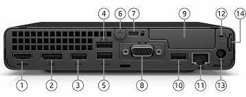

Yikes. My HP ProDesk 400 G6 doesn't have a SATA port. Can I achieve the same with a serial port? Options look like:
Or would an e-sata to usb cable get around this issue?
Best idea would be different computer.
You have a SATA controller, don't know how many ports. SATA to eSATA is just a different plug on one end of the cable. If you had an eSATA enclosure with separate ports for each disk, and there were enough SATA ports on the motherboard, you might make that work.
