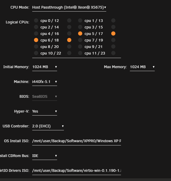

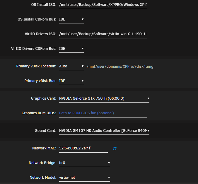

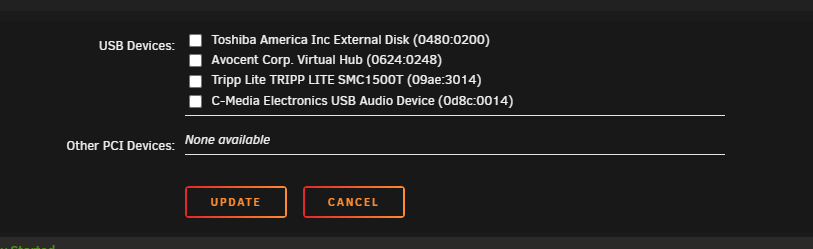

Sorry i should have been more specific.  By Log Looks Normal, I meant to say that the VM Log output is the same whether I boot into Windows XP using VNC(that works) or whether I try to boot using GPU Passthru(that doesn't work) .  Also the system log is not revealing anything.  Here is what my VM config looks like:
