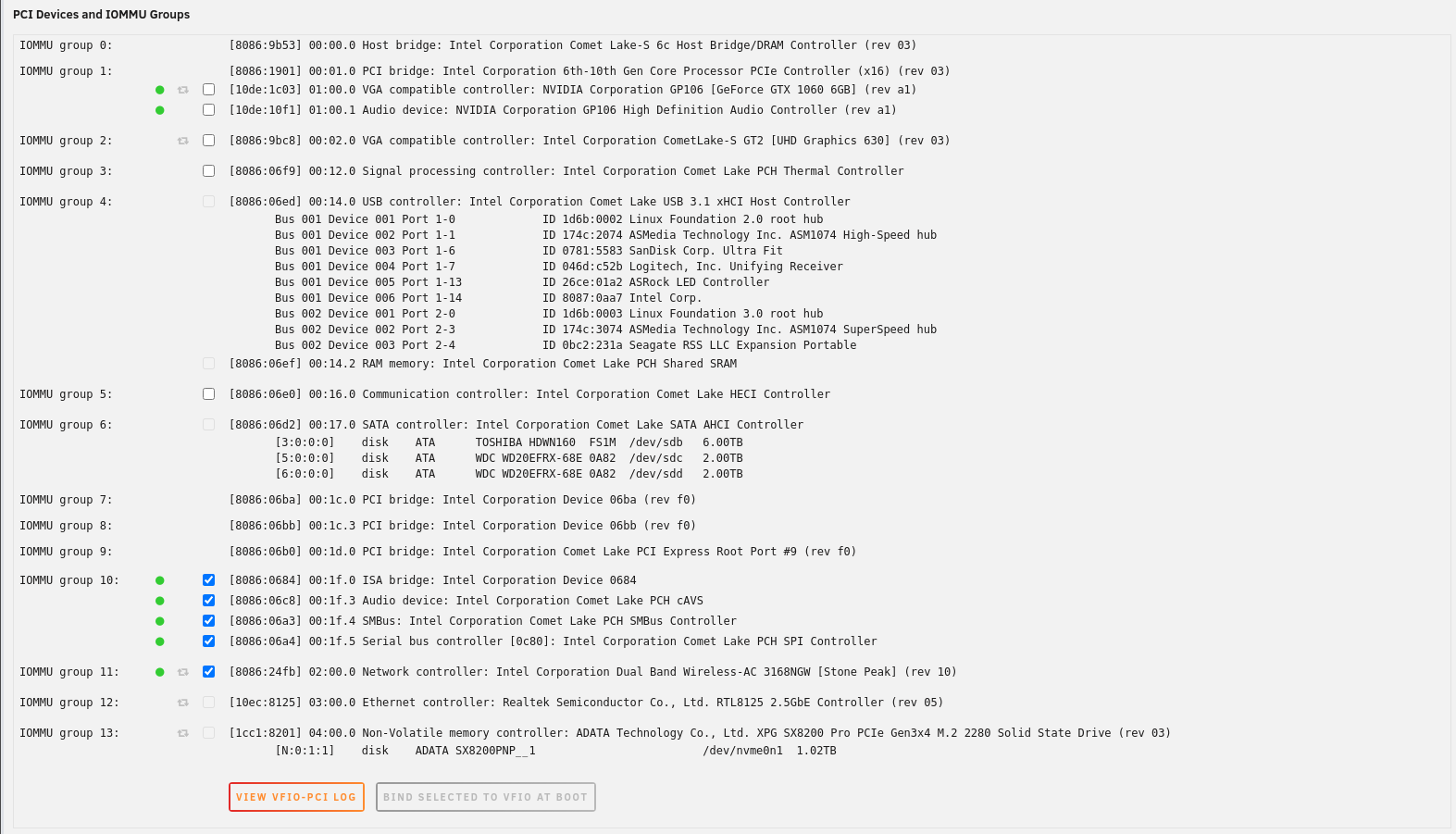

Top of my head:  You've got a couple of VMs running and a couple of devices (sound etc) presumably passed through to the VM.  Are you passing through a video card to them?  Are you using the iGPU for passthrough?  I don't see any video being "isolated" from the system to prevent the OS from using it.
When the computer is "sleeping" after some time of inactivity, and the signal of the WOL appears I can't access to computer. It doesn't respond.
the previous string with white and black text logs don't appear.
Sorry by the soft explanation. I mean that I can see the "syslog" on screen monitor whem server boots, but not when it is wake up from LAN. I can't write anything before and after. I haven't a terminal, only logs (maybe I am wrong here). The key: after WOL action, I can't see anything in screen monitor.
I have two VM and a NVIDIA graphic card atteched to both. I normally use only one VM at same time, because it is impossible use both. When I force the sleep state, both VM are powered off. Only dockers are running.
The iGPU is not used in any VM, but I don't know what you mean from passing passthrough or isoloted. Maybe the issue could come from there? What do you want to try?
I tried some hours ago with VM service disabled. But same results. Maybe is the iGPU, but... why when it is restored from a S* state?

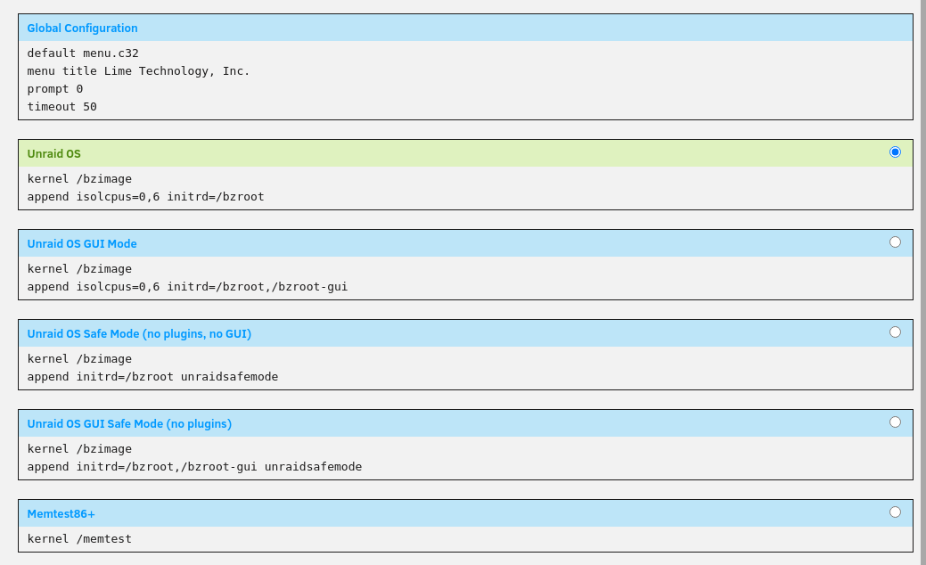

I checked kernel loaded modules and are the same in safe and normal mode. Is something loaded in normal mode that is not present in safe.
Could be the isolcpus? Is the only parameter not present in the normal boot. But I don't understand what is the effect.
I created a new entry in boot without isolcpus... and it worked as expected. I will try in next days to understand why:
  • It's a configuration question of pinned cpus?
  • What are the implications of isolcpus? Why its related with the sleep mode? Maybe it's a bug?
If someone have some clue, could be very helpful.
