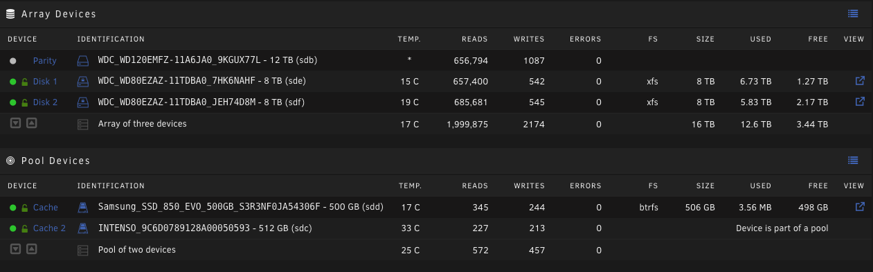

I'm running into an issue with mover that i cannot resolve.
It's refusing to move any files and errors with:
move: file: /mnt/disk2/martin/folder/to/img/IMG_0194_square_Fotor_edit.png
move: create_parent: /mnt/disk2/martin error: No space left on device
so everything is in its place, except for the share `martin`. I changed that from `cache: yes` to `cache: prefer` which should move it from my array to the cache. But every file fails. And it's not related to that share as it happened to other shares also and its not to a specific array disk , as both disk1 and two fail.
I still have plenty of space left on each drive and the `martin` folder only contains documents and is under 10gb, prob even under 3gb.
1215391066_Screenshot2022-01-29at12_22_33.thumb.png.b987662688ff88d14a69aa5fd46c9f48.png
What i did before this happened is to move from a single cache drive with xfs to a cache pool with btrfs. for this i moved every share to the array with "cache: yes", verified everything is fine, rebuilt the array with a btrfs cache pool and here i am with this problem.
Thanks for any help with this, its hard without my dockers up
