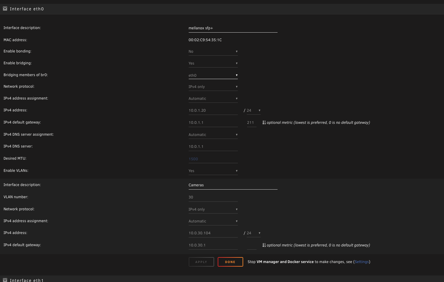

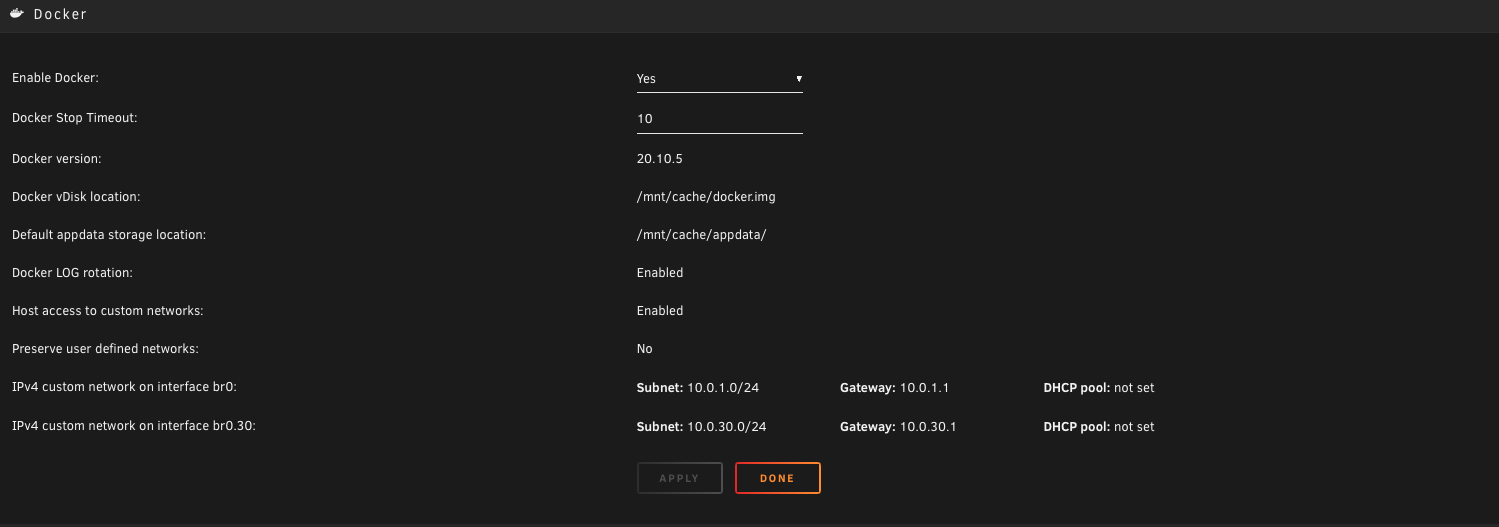

Network settings-
1558749050_ScreenShot2022-01-30at11_02_28AM.thumb.png.29a408c3fe525df0a4535bb8c73173b7.png

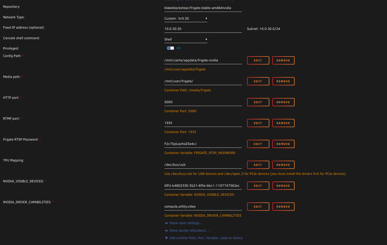

Docker settings-
34399324_ScreenShot2022-01-30at11_06_02AM.thumb.png.8f12fc98eba63846a6ab5cd05acf0b0a.png

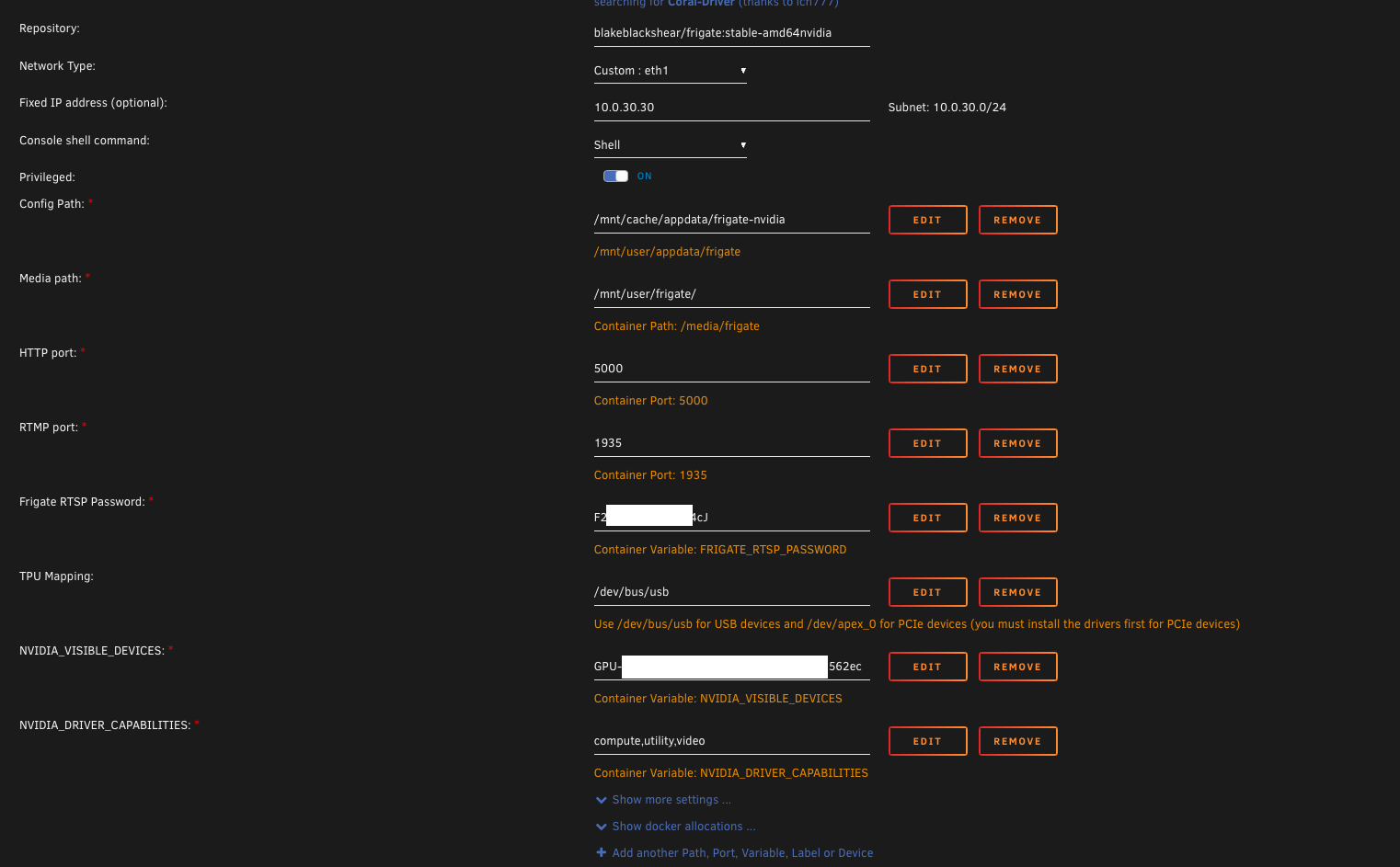

frigate settings-
2111265895_ScreenShot2022-01-30at11_15_20AM.thumb.png.ee3ed8c997d93d28a47e5d7d63d9a68b.png

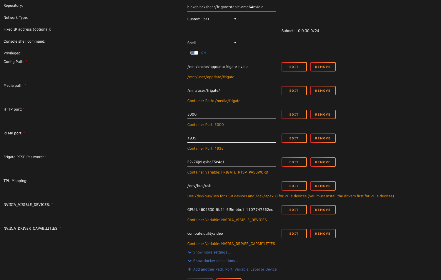

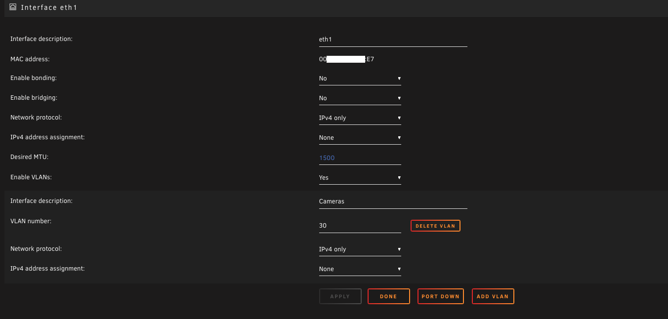

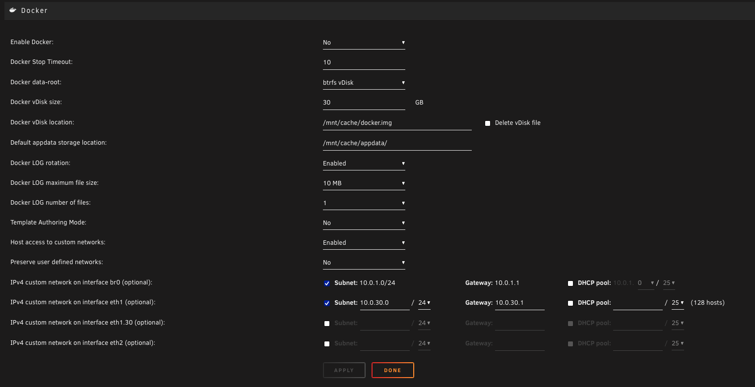

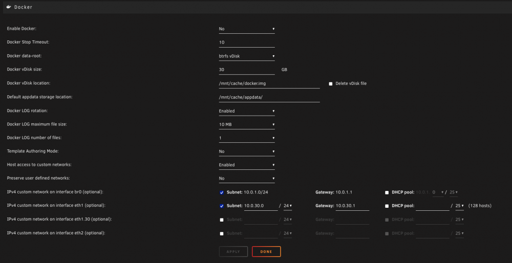

New settings-
2123860512_ScreenShot2022-01-30at8_54_53PM.thumb.png.75d63e305f87399fd6020907fc0d1152.png
555612250_ScreenShot2022-01-30at8_54_27PM.thumb.png.57e9b16f6580e730eaee4b341ec5d2f6.png
2120460228_ScreenShot2022-01-30at8_59_21PM.thumb.png.0ee1ef5261bb5b8078da762db7fa6d90.png
No luck. Still get the same error. Tried setting a static IP in the docker container as well.

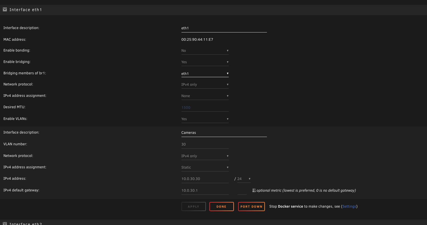

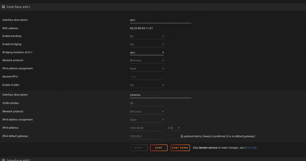

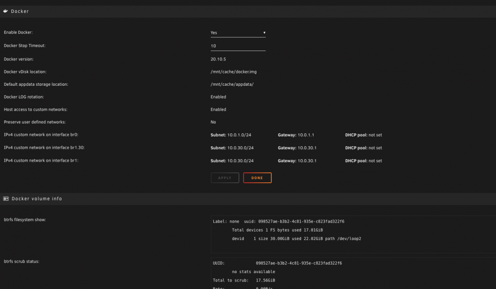

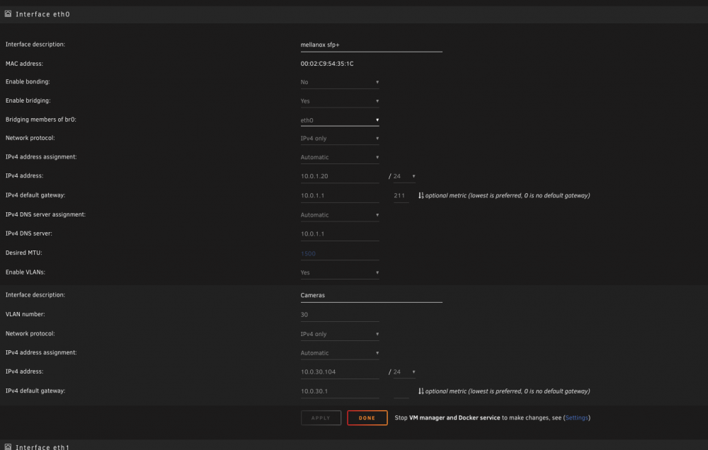

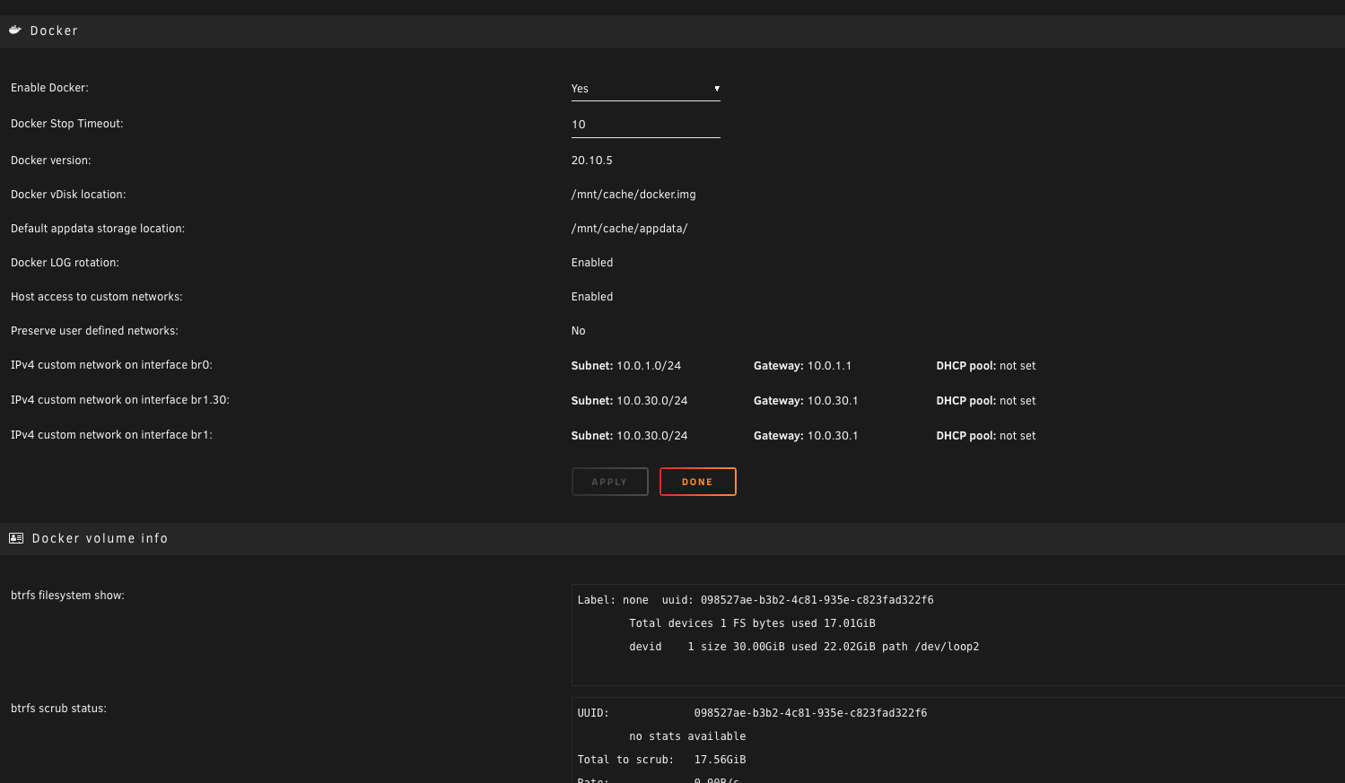

I think I finally got it. 🎉🎉🎉
I was trying to setup the VLAN on an unused nic when I really just needed to enable it on the port used by the server.
390534779_ScreenShot2022-01-30at9_25_59PM.thumb.png.3f990d47d4b86651ac0ca3ea16c82ac5.png
1826867355_ScreenShot2022-01-30at9_26_32PM.thumb.png.127c2b97c2604bf1b0dd3085e68e0bf4.png
1783691149_ScreenShot2022-01-30at9_27_48PM.thumb.png.a9bebe5d1808b63a719a86e321238375.png
This setup seems to be working. Is there anything wrong with it?
I'm obviously a complete novice when it comes to networks.
