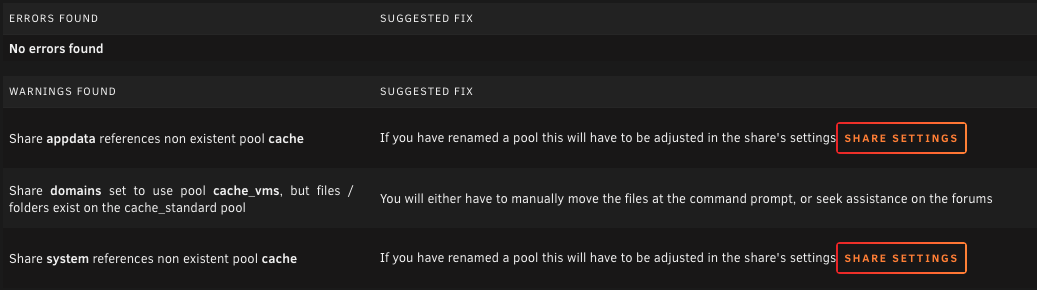

So yesterday with the high winds we had a powercut for about 15 minutes - when power was restored and I rebooted my server I got the notifications shown in the attachment.
I call them weird because I haven't changed anything for months:  I haven't renamed a pool as far as either appdata or system shares are concerned. I have 2 cache SSDs called cache_standard and cache_vms with the latter being used for VM related stuff - isos, domains etc. Been that way for well over a year.
Re the domains share it's possible that there maybe some files/folders VM related stuff I did over 18 months ago, but that begs the question why this hasn't been flagged up since?
Obviously I suspect the power outage has messed something up and I'm wondering what to do about it? Apart from these alerts in Fix Common Problems everything seems to be working as normal. I rarely boot up the sole Windows 10 VM I have installed, as this is only a 4-core CPU and it's got its work cut out to keep up with media server duties.

Post your diagnostics because the implication is that a drive is no longer present on your system (if only because I need to see if there's a mistake in the detection code)
So, I looked at the appdata share
shareUseCache="prefer"
shareCachePool="cache"
# Share exists on disk1,disk2,disk3,cache_standard
And these are your cache pools
Jan 29 12:14:35 SINGTHESIS-NAS emhttpd: shcmd (43): mount -t btrfs -o noatime,space_cache=v2 /dev/sdb1 /mnt/cache_standard
Jan 29 12:14:35 SINGTHESIS-NAS emhttpd: shcmd (45): mount -t btrfs -o noatime,space_cache=v2 /dev/sdc1 /mnt/cache_vms
Net result here is that any new files for appdata are being written to the array because the "cache" pool does not exist at all.  Once you change the settings to properly reflect which cache you want to actually use, disable all the services in settings and run mover.  After it's done re-enable the services and you should be good to go.

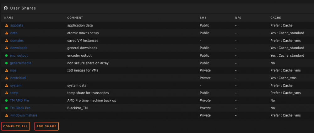

Hi Squid - what I don't understand is I haven't changed anything - When I look at the attached screenshots, User Shares shows that this mysterious 'Cache' is assigned to appdata and system,

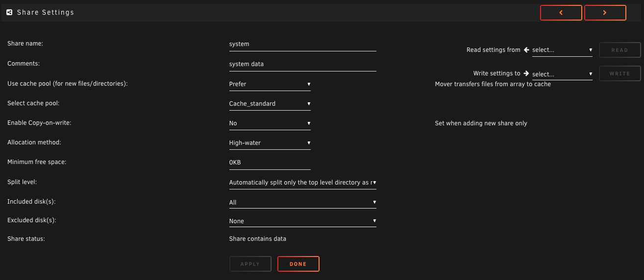

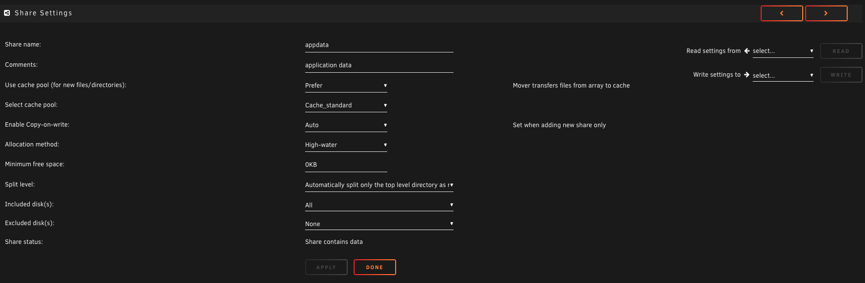

but when I select those shares they both show themselves to have been assigned to cache_standard as shown below:
That's how it's been for as long as I can remember - the cache_standard ssd having been there since I first installed unraid - I added the cache_vms drive a year or more ago. It might be that when I added the cache_vms drive I renamed the original cache to cache_standard - I don't remember. Either way though, nothing has changed for months as I recall, and until the power cut the server had been up with no errors from FIx Common Problems for a couple of months. Does a bad shutdown maybe cause the system to do a deeper level of self-check ? i.e. that might reveal something I messed up months ago?

Both your shares screenshot and the diagnostics show that the system isn't what the individual shares may say.  (They may be showing that because there is no "cache" drive and that's what it's defaulting to).  Make a change (any change) and revert it then apply and the continue with my directions.

Hi Squid - thanks to your instructions no more errors re appdata and system, but the process doesn't seem to have done anything for the domains error - I tried switching the cache, running the mover and then switching back and running the mover again. But it still says
"Share domains set to use pool cache_vms, but files / folders exist on the cache_standard pool"
However when I look at the /mnt/cache_standard/domains folder contents it says it contains 0 objects: 0 directories, 0 files (0 B total)

Even though it is empty just the presence of the domains folder could cause that warning so delete the empty folder.
