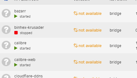

Since I've made that change, I'm having problems with things I'd describe as "background" internet connections - plugin downloads, Docker updates, Plex remote access - all of that just does not function anymore.

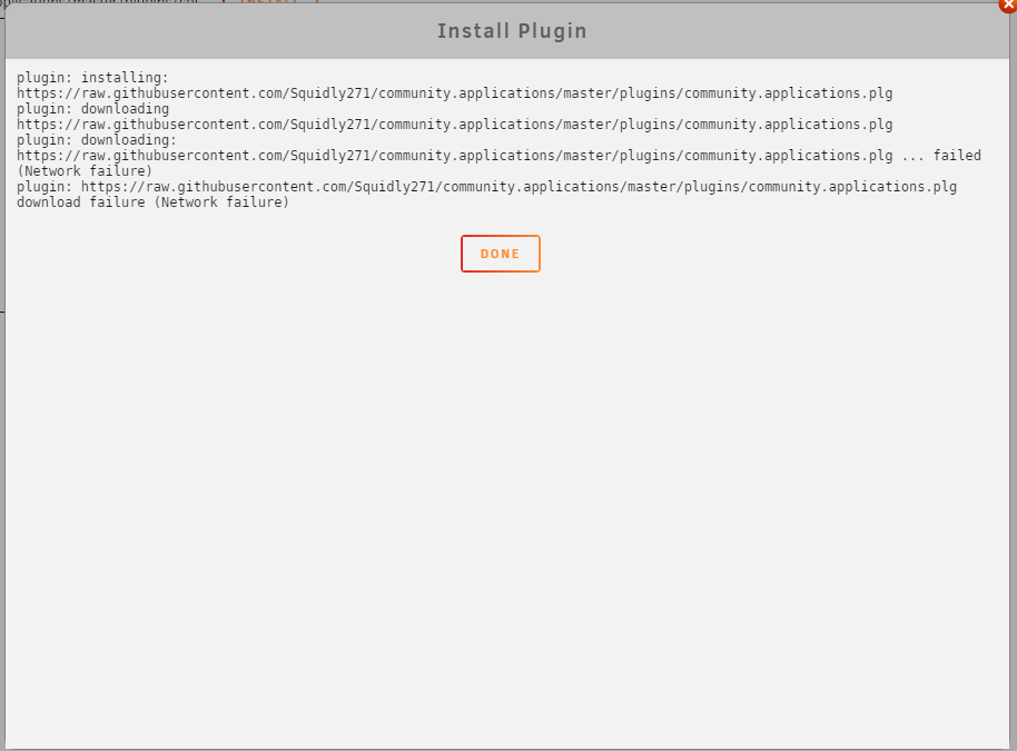

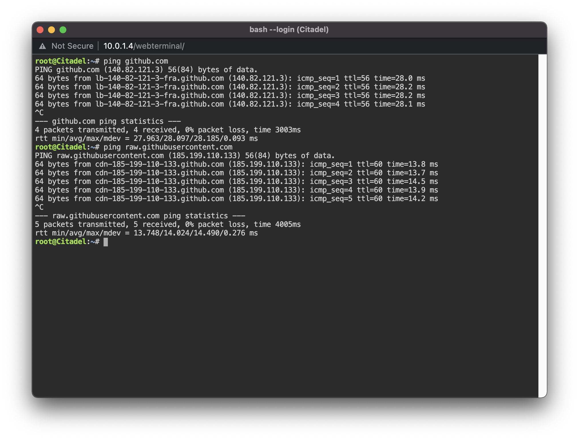

Pinging works fine, I can ping web addresses and ip address (both internet and external) without issue, but when I try to do something like install a plugin it just will not work.
When I go to my docker tab they all say "not available" under the version column.
I've tried changing my DNS servers on both my router and in Unraids settings to default, openDNS and google DNS. I've tried resetting my network settings completely by removing the config file. I don't have an active pihole anywhere on my network.

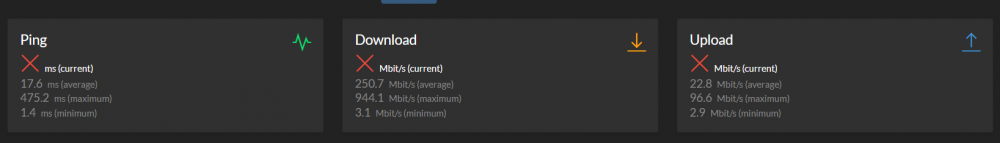

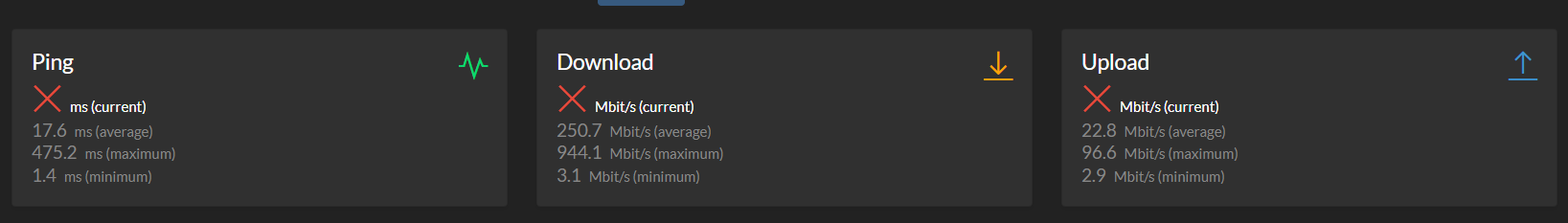

It seems like docker containers in general can't access the internet, for example my speedtest docker shows no connection.

Yep, and raw.githubusercontent.com as well.
1438871096_Screenshot2022-01-31at11_30_38.thumb.png.6f8014924fa1a373472ebdb7ba7870e4.png

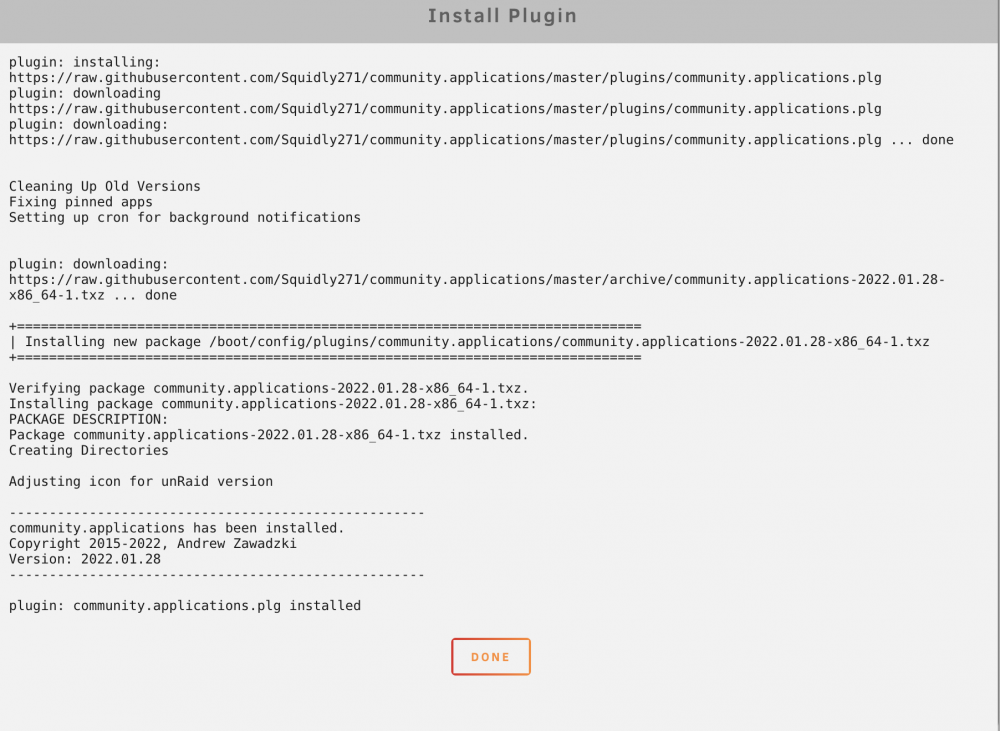

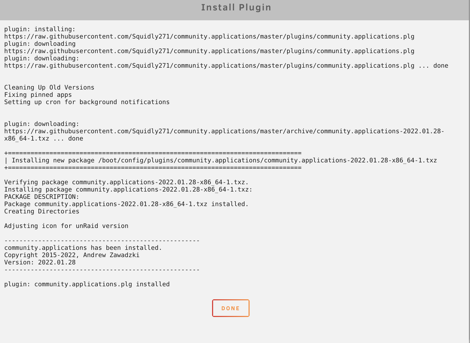

I'll add one thing - I tried with a new USB stick with a trial version of Unread installed - same issue trying to install CA. Switched back to the FritzBox - instantly installed:
518209676_Screenshot2022-01-31at11_49_22.thumb.png.b014a94d165364f7ccbd7b4f8853d31a.png
So whatever the issue is, its specific to the Netgear Orbi or its configuration. I'm sure that means most people will wash their hands of the problem, but if anyone has any idea what I could have configured on the Netgear that would cause this issue, I'd love to hear some ideas.

On 3/13/2023 at 11:18 AM, trendykendy said:
I know, I was banging my head against a wall for days trying to figure it out. If you do, let me know, I still have the Orbis laying around!
Seems like it was down to the dockers being set to use IPVLAN, switching to MACVLAN cured the issues.
I've also just discovered Giganet uses CGNAT rendering it useless for my needs due to unable route traffic to my server. I'll contact them tomorrow to see if they can provide a status otherwise it's cancellation time.
