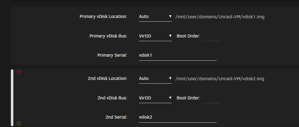

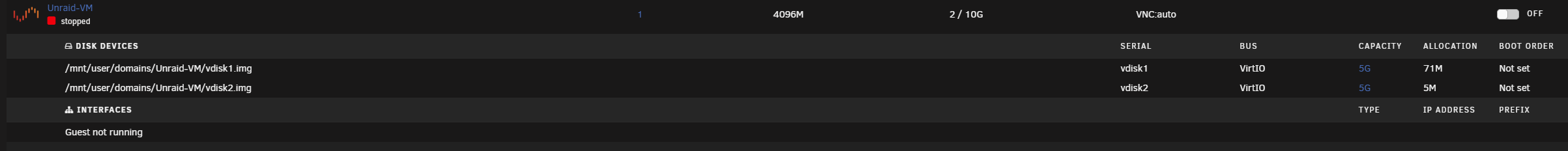

It has been added to the GUI for 6.12
Edited by SimonF
Ohh perfect! Thanks so much! That was actually my initial thought but then when I went to do it all the other parameters were inside the < >, so I second guessed myself and didn't want to screw things up haha. Thank you!
Oh and I didn't even think to check the gui! Thanks so much!
