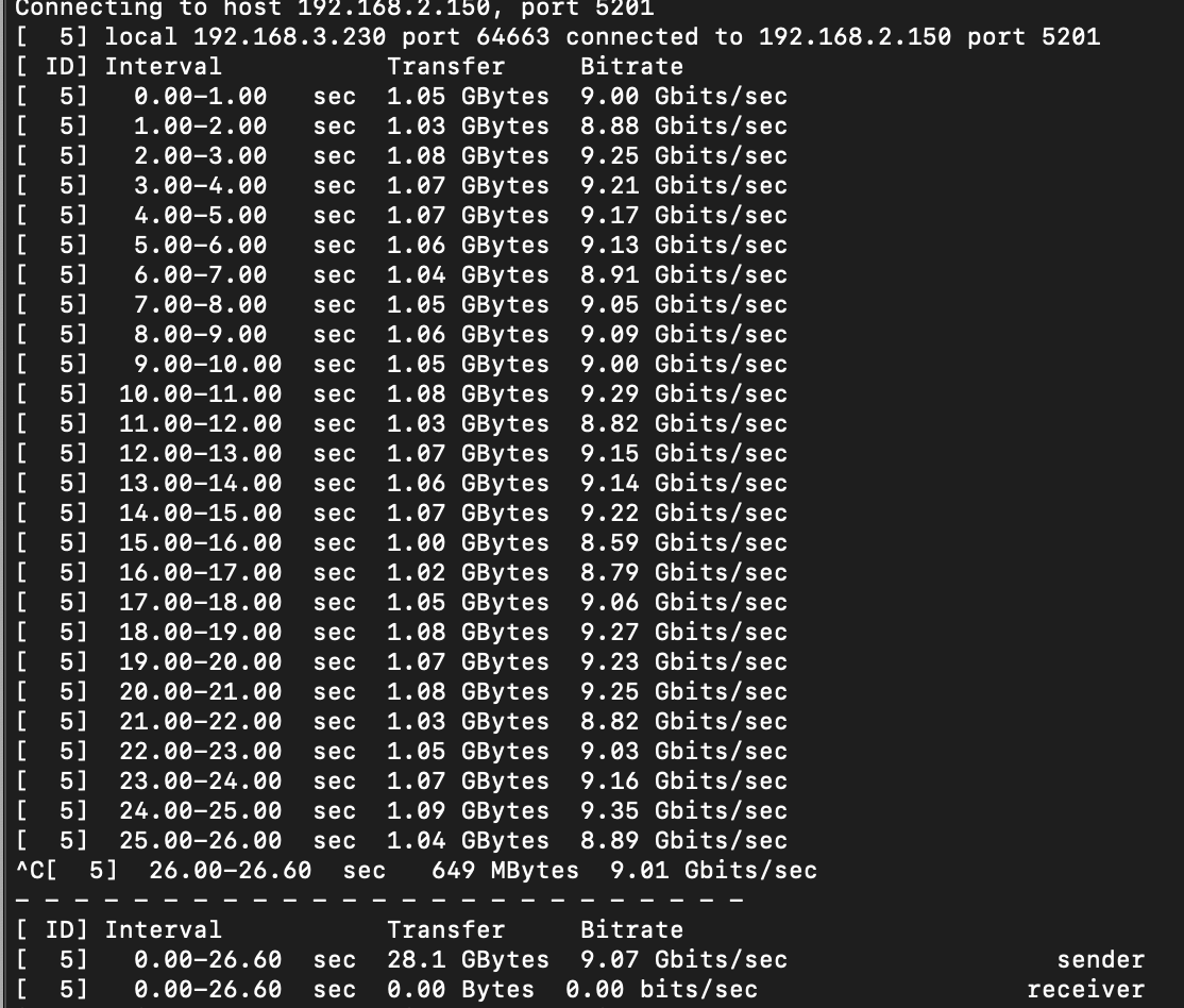

Here is what I get with Macbook as iperf3 Client
1474112634_Bildschirmfoto2022-01-31um21_39_43.thumb.png.4cb769c8df7db88eda6bc7a020eaaee4.png

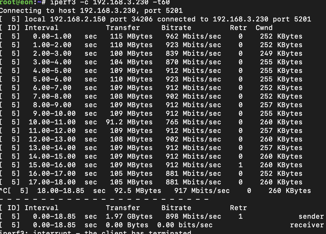

And the other way around I only get this
1600361942_Bildschirmfoto2022-01-31um21_42_51.thumb.png.dd8997ff8056390f82c01a8ecb880481.png
I tried the same with my desktop as iperf3 server and the unraid as client. Unfortunately the same results
Does anyone has an idea what is limiting the speed or where I can look further?

Thanks for the hint. I don't know why I didn't try that before, but finally that resolved my issue. The unraid server had a 24 bit net mask (for historical reason) while my network already has a 23 bit net mask. So the whole traffic went through the usg router which is only capable of 1g switching. Changing the net mask did the trick 🙈. What a dumb mistake...
